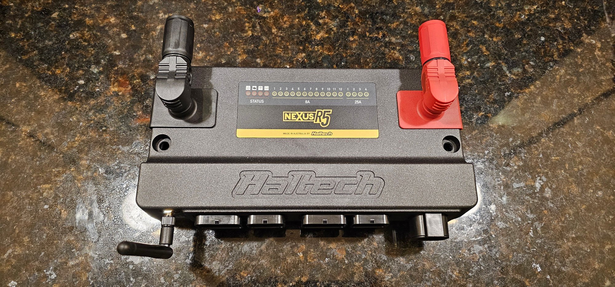

Just had this show up for the next phase of my build. Pumped to rip out all the oem wires and start from scratch. I considered R3 + PD16, but ultimately YOLO'd to R5. I'll likely end up adding another PD16 to handle rear of car anyway.
