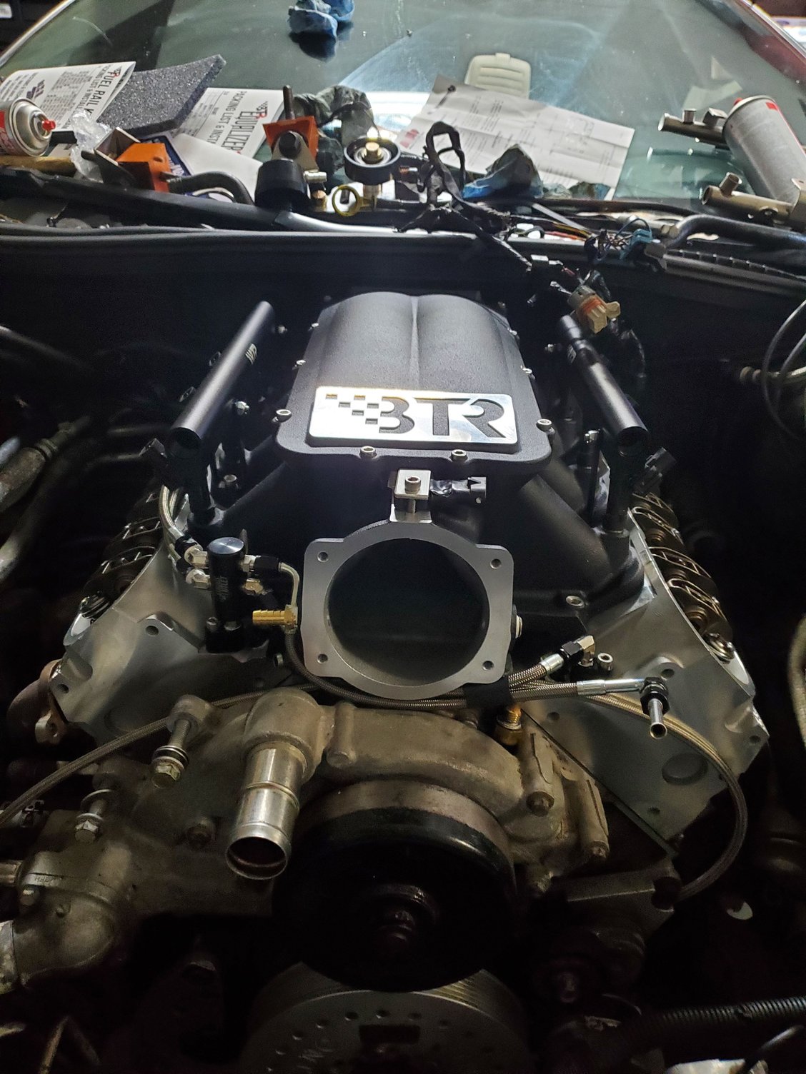

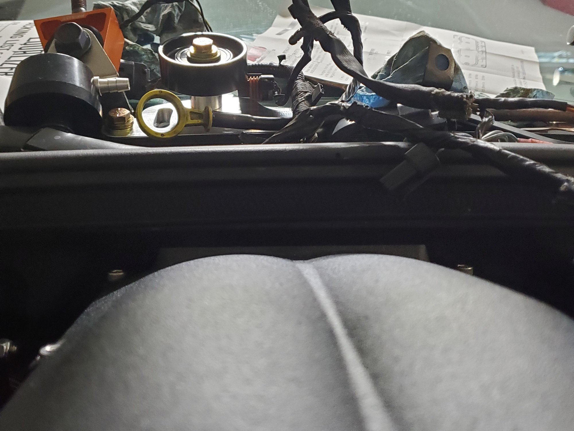

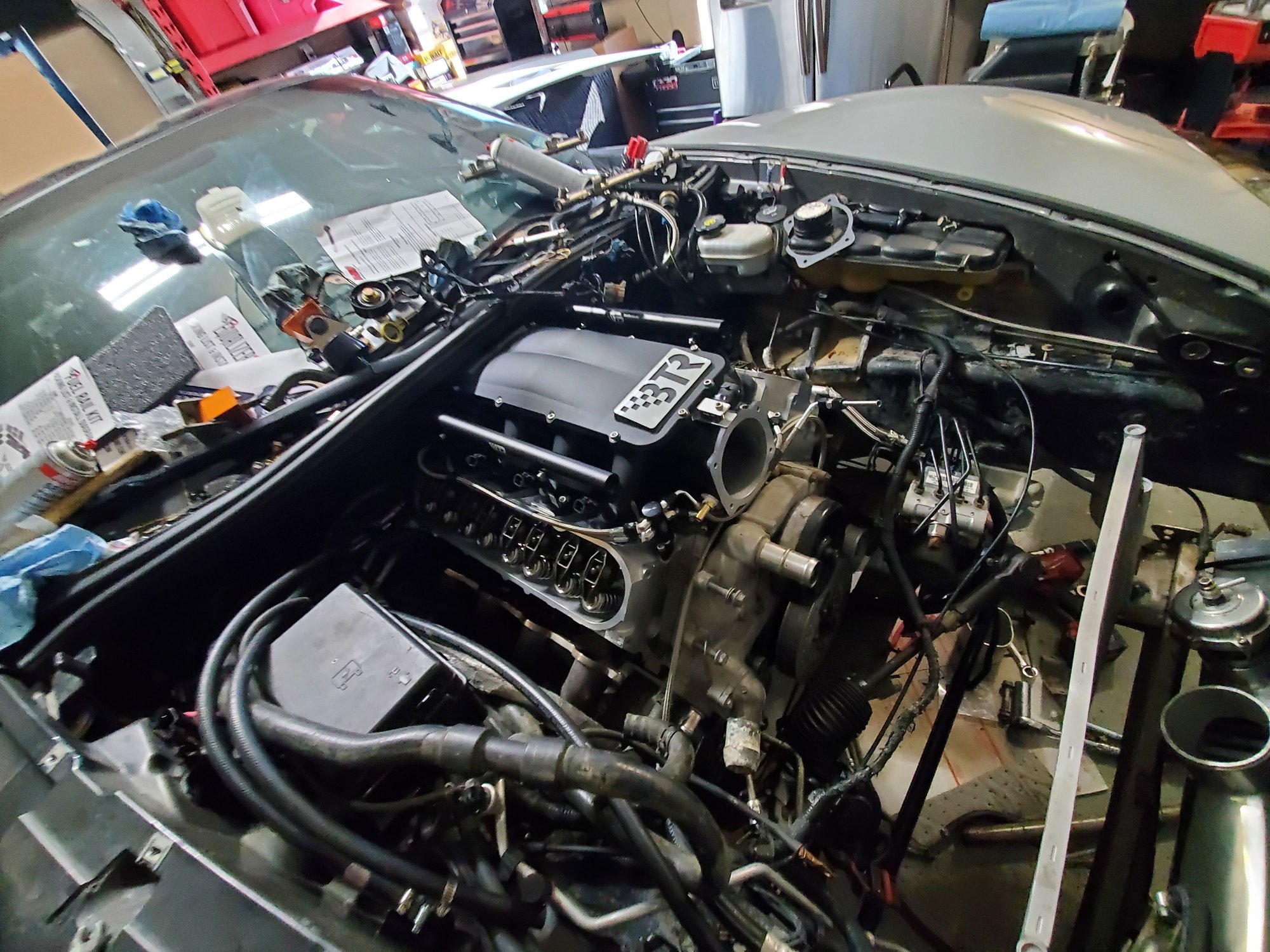

I have BTR equalizer in my C5 with ls2 tb. I have return lines back of both fuel rails and i have to modify abit firewall even with stock ls3 intake manifold. I am not sure did that fit if you dont have return lines end of fuel rails. Car make about near 100hp more with btr and i cant feel did i lost something in lower rpm.

Are you on factory height engine mounts? Or did you lower them at all? Looks real tight at the firewall.
And can the plenum be reversed to put the flag in front? I am really picky about not putting logos in or on the car where they can be avoided. Brian is a guy I fully respect for several reasons, but I don't want BTR dead center eye catching in the engine bay. I might grind em down and repaint the intake if I go that way.

I have PDAFT engine mounts and i think they are about factory height. It fit tight but not hitting anywhere. I am from Europe so i didnt try put flag to front, but its look symmetrial and flag can be in front.

I had an equalizer on my c6 and no issues hitting the Firewall. Poweband was noticeable mid range to top end.

Thanks for the pictures. Looks to fit decently.
