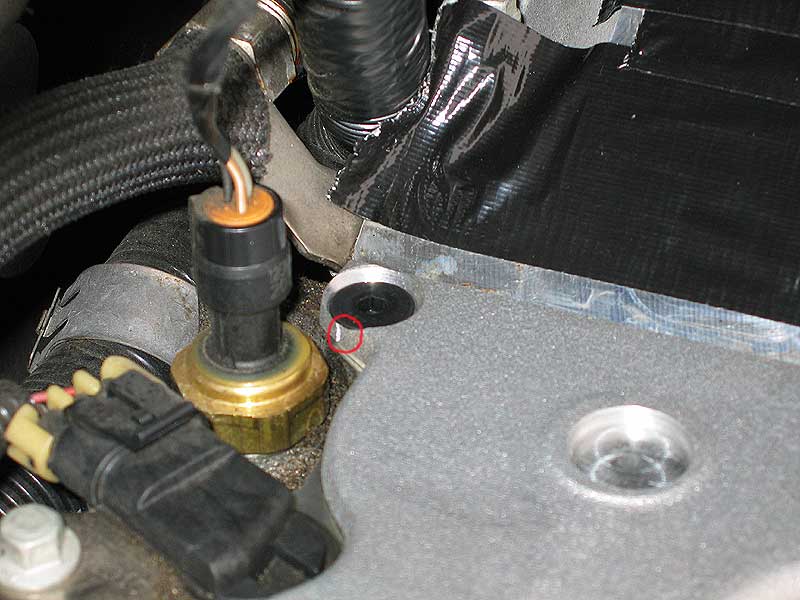

I was set to install the supercharger and work on the fuel pump tomarrow when a setback came into play. As I was torqueing the new valley cover down the rear bolt hole cracked through. My heart sunk when I heard the sound and felt the torque wrench ease up. Here is a picture below:
The metal is extremely thin around those edges on both of the rear holes. I will call Magnuson tomarrow.

Talked to Tony up at Magnuson today. I'm not the only one who has cracked one of these recently. Turns out its not a casting problem or a fault the problem lies with the torque specs. He recommends 11ft lbs instead of the 18 the manual mentions. He was nice enough to send another one out today and send a prepaid mailer for the broken one to send back. I have to say......everyone at Magnuson has been fantastic to deal with. Excellent customer service!
