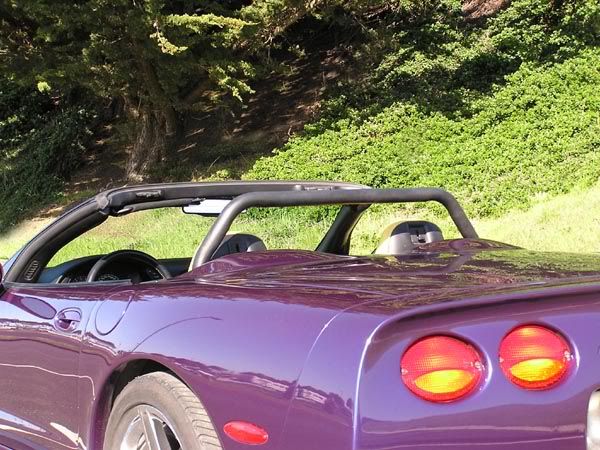

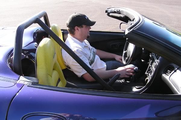

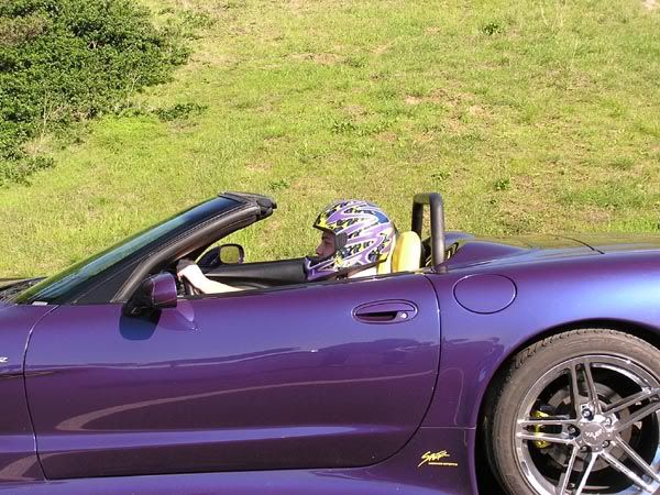

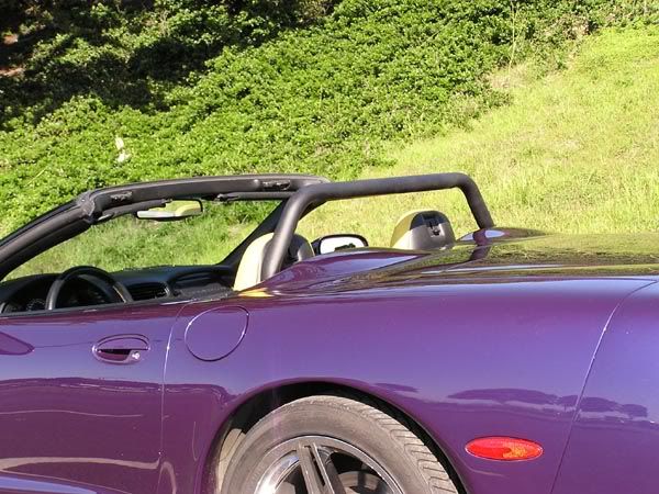

Like 2000BSME I'm tall - Not 6'8", but 6'4" and long-waisted, so I sit very tall in a seat. The only rollbar on the market that I could find was the Wolfe Racecraft bar. With it you lose 2" of seat travel, and for me the bar bangs up against my head just sitting in the car without a helmet. Plus my head sticks up about 2" higher than the bar -- So effectively NO protection! . . . Probably actually ADDS a safety hazard!
So I built my own also. Mine sits back away from the driver and sits as high as you can get and still fit under the top when its up. Also, it's high enough that it does no restrict rearward vision at all. To do that and get enough rearward position and height on it, I had to mount it so that it swings forward to allow the top to go up and down, and then it locks into place. Otherwise the movement arc of the top severely limits the height and rearward position.
I built a locking lever/plate system from 1/4" steel plate with a 5/8" hardened steel locking pin on each side. It's hinged on 1/2" grade-8 bolts. The 1/4" steel base plates (2 of them - each 6" wide) wrap around the steel ridge of the body pan that runs the width of the car just behind the seats (one base plate behind the each of the seats). The base plates are then welded into that steel ridge.
The rollbar is also stabilized by a locking bar and pin anchored with the upper seat belt mounts.
The rollbar itself is built from 2" tubing (.120 wall thickness). The rollbar is easily removable by simply pulling the hinge bolts out. The base plates remain in the car, but can easily be covered with a section of carpet placed over the ridge.
And as you can see in some of the pics, there is also a front brace bar. This bar installs/removes easily with just two bolts. I tend to leave it off for street use, and put it in for any track use (though I've since bought a daily driver/track C5, so I don't track this car anymore). So without the front brace it actually has 4 mounting points (2 @ the base plates + 2 @ the upper seat belt mounts). The front brace adds a 5th mounting point and a very significant amount of structural stability.
I'm sure this by no means meets any formal racing regulations. Thoug it's mor ethan enough to pass any HPDE or track day events. But I figure that it's about the best balance I can achieve between safety and preservation of daily use and function. It only adds less than a minute to putting the top up or down. It's far enough from my head to not be a hazard in itself. It's high enough to actually provide some protection for me.
BTW - The guy in the seat is not me - It's my son (he's 6'2").
