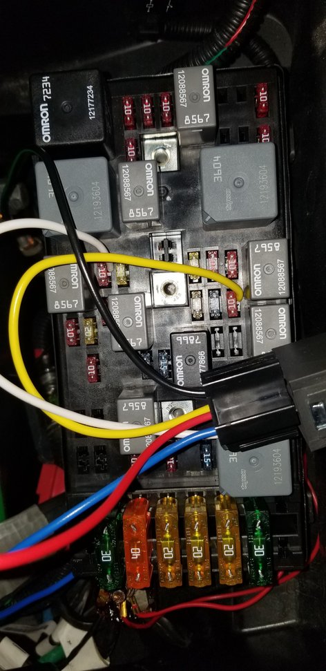

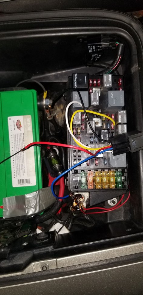

This is what I did and once I connect it to the battery the lights pop up without the lights being on.
Click here to check Post 18 above for detailed instructions (scroll down to the bottom of the Post). Follow them exactly and let me know how it goes.

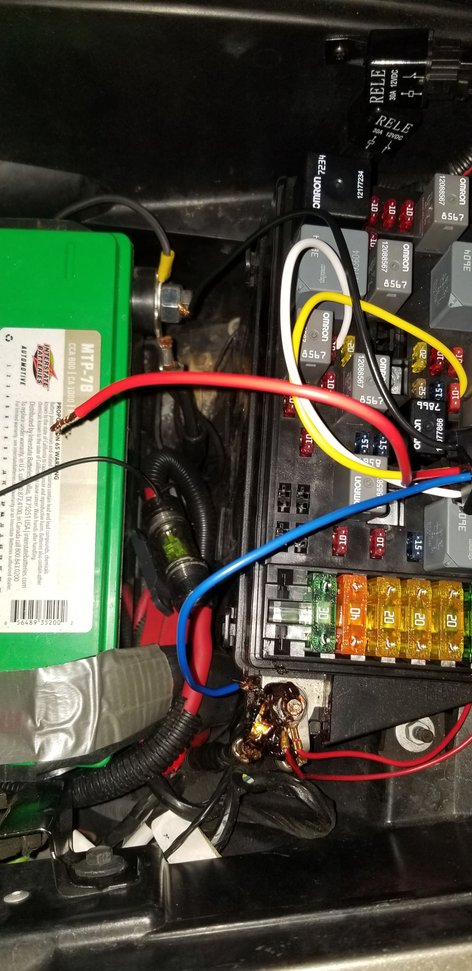

I did exactly what you said and neither low beams turned on. I didn't use the red wire this time.

I just hope you didn't damage your fuse box by forcing the stripped ends of the wires from the relay along with the fuses...

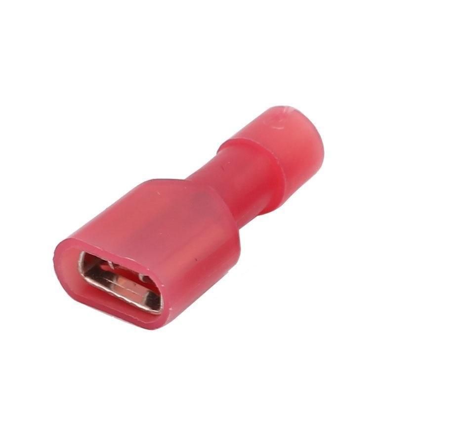

You probably have bad contacts. You need to crimp female spade connectors like this one to your white and yellow wires:

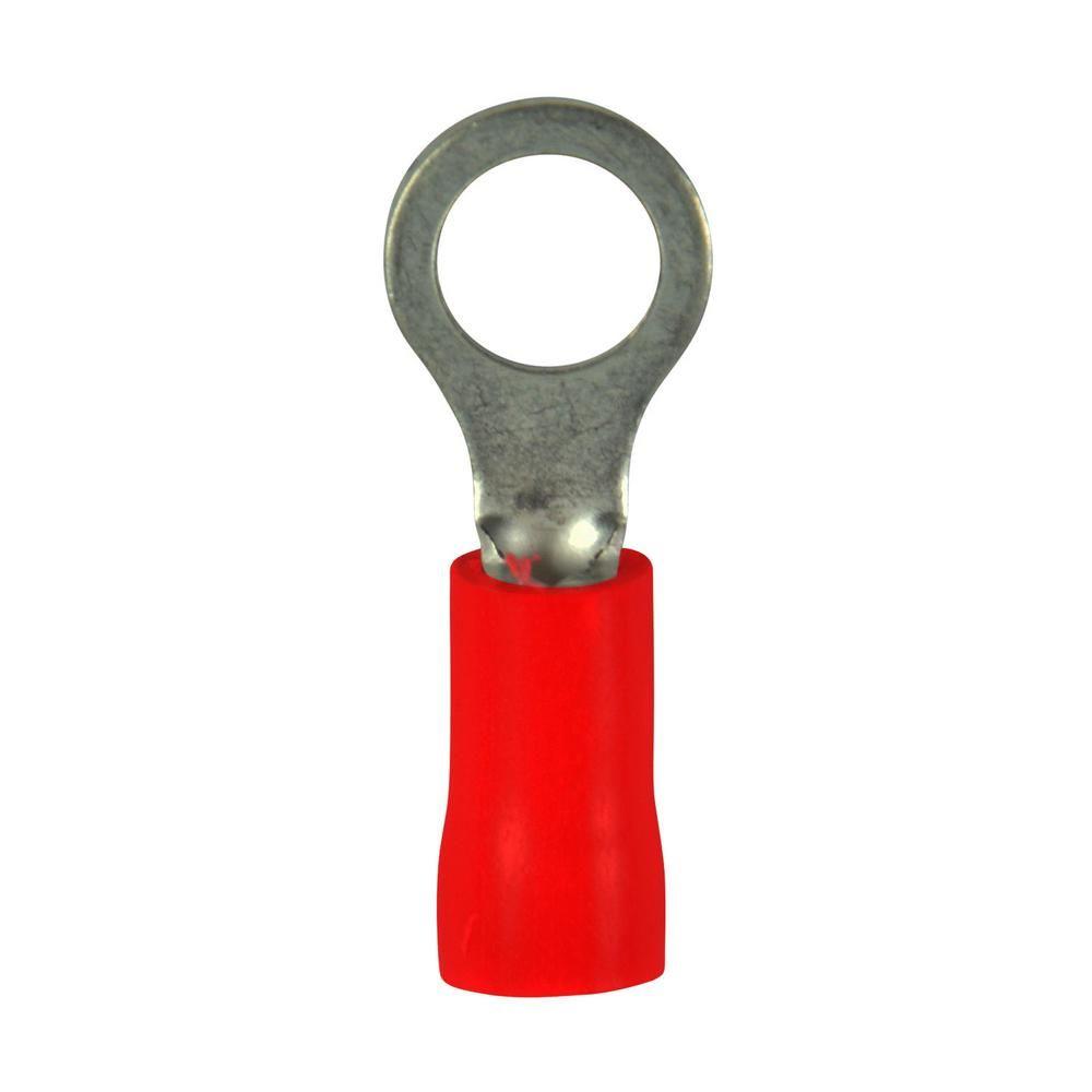

You need to crimp ring terminals like this one to your black and blue wires:
You need to use fuse-taps like this one and connect them to the female spade connectors from your white and yellow wires:

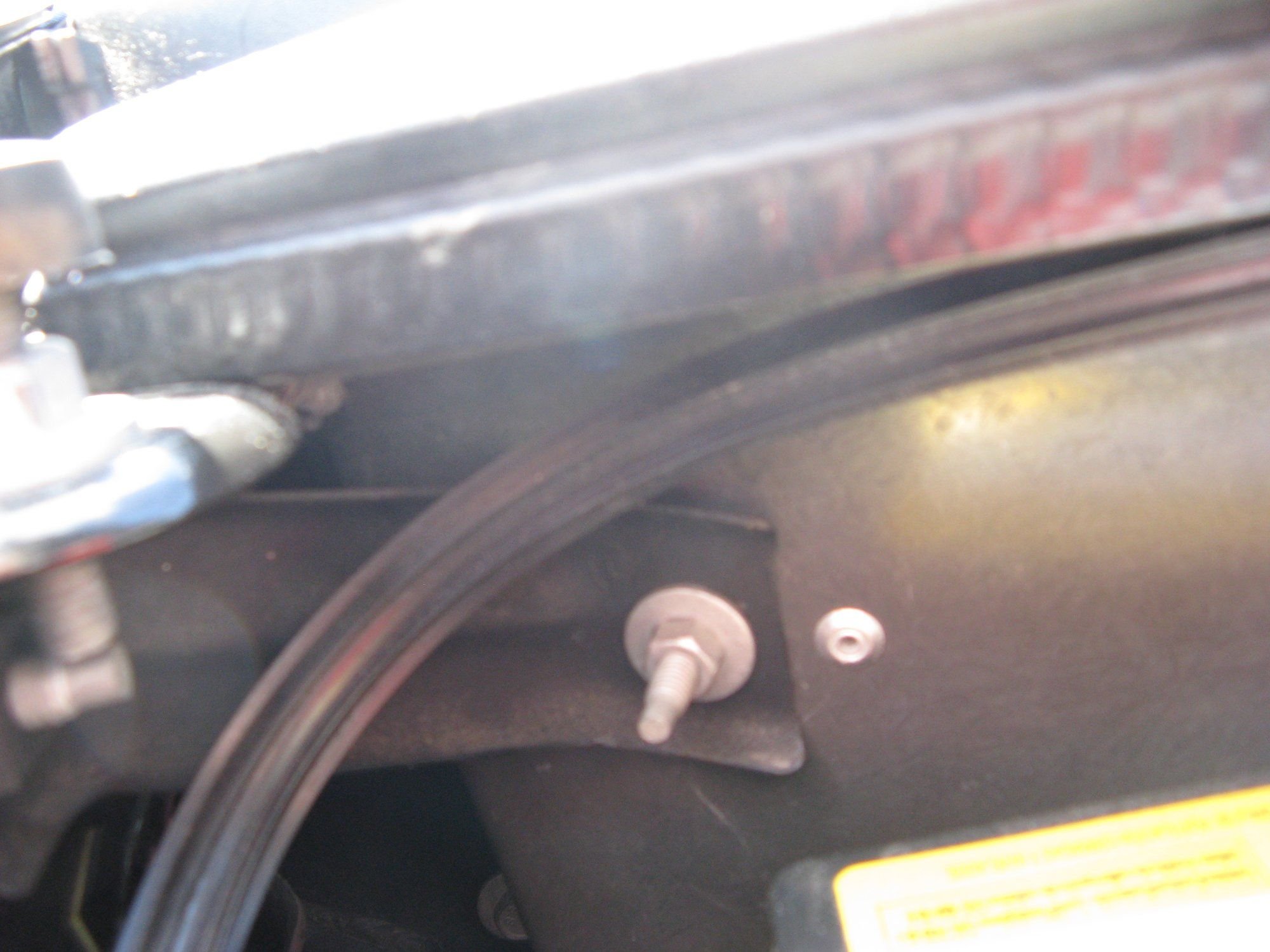

And lastly, I can't see where you connected the black ground wire. You could connect it to this metal bracket and secure it under that nut:
