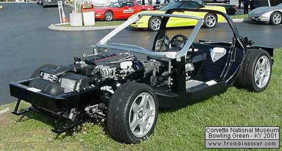

Actually... there are no "exta" parts... The coupe has the B-pillar roll bar/hoop part than can be seen below:
The vert looses this roll hoop and instead has a cross brace that goes just under where the tonneau cover and deck lid mount and hinge from.
The C5 convertible is actually 10 or 15 pounds lighter than the coupe

The point I'm trying to make is that this has NOTHING to do with frame "twist" of "flex". Your C5 has one of the best chassis' on the planet... they're amazing and they really don't flex... even in convertible configuration.

The C5 frame is 4 1/2 times more rigid than previous frames.
The C5 is designed around a convertable frame.
