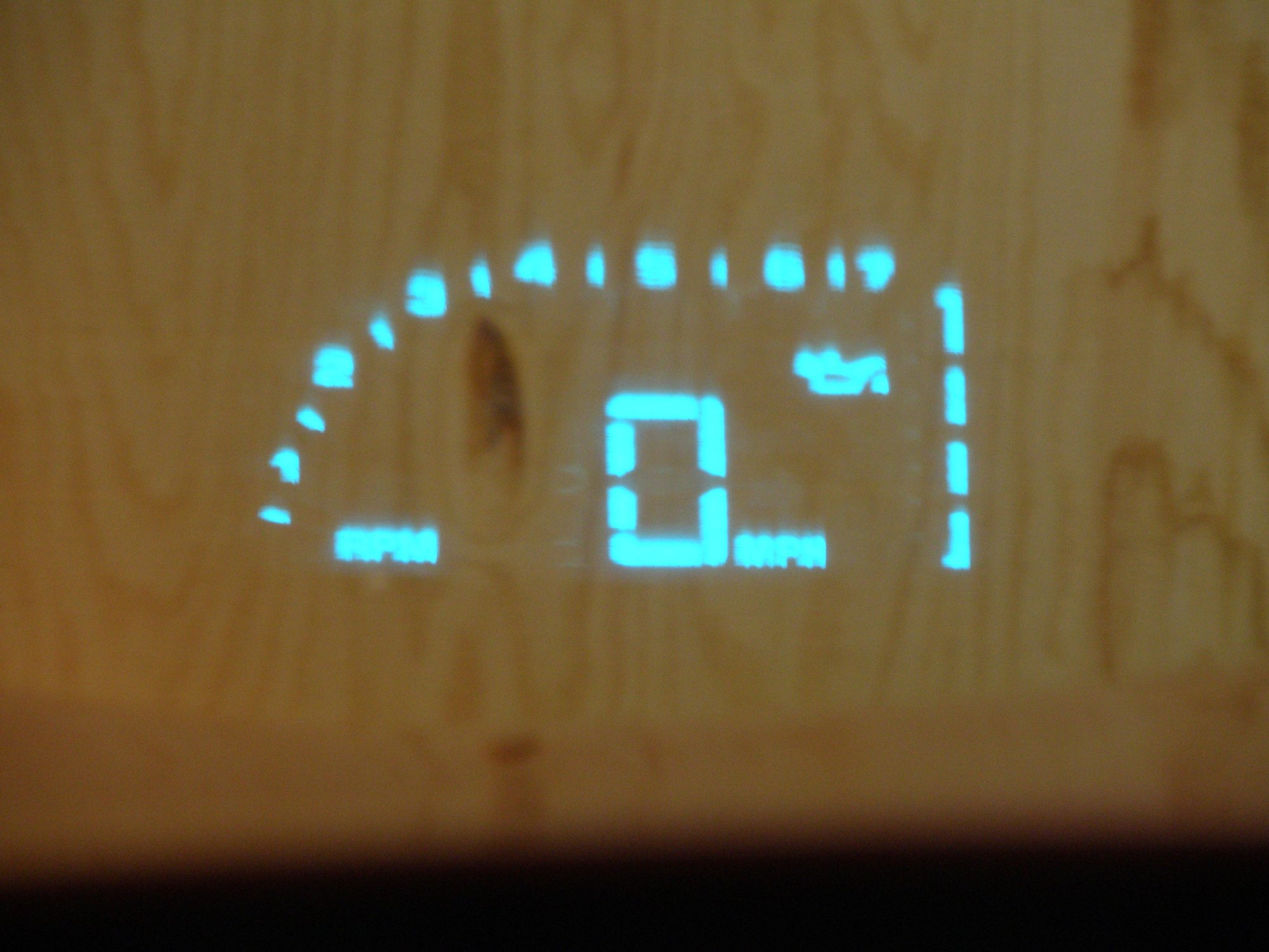

3. Will HUD display properly with None GM glass?
Yes it will, but there are rare cases that you will have double vision (double reflection) reported by other user in Corvette Forum.
The glass that was in my 1998 Corvette Convertible was not the original and the HUD was clear with single contours.
The glass that was just installed for the Total of $333.56 including everything. I mean final price including tax. Is also displaying properly.
For your reference I am providing you with both windshields details:
Old: E6 43R-009047 SHADED Solar Ray safety AP FLO-LITE AS1 Lamisafe Tech DOT-375 M334
New: FY FUYAO AS1 M854 DOT 459 Solartint DW 1325 7
Here are the actual pictures how my HUD display it now. Please note that I can see it clearly on my windshield, the tiny distortion comes from my camera that obviously could not use flash. There are no double contours reported by one user before.
Picture taken in my garage.
Little bit more closeup.
