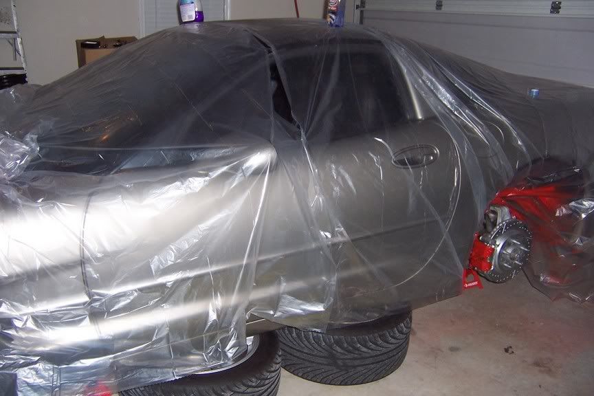

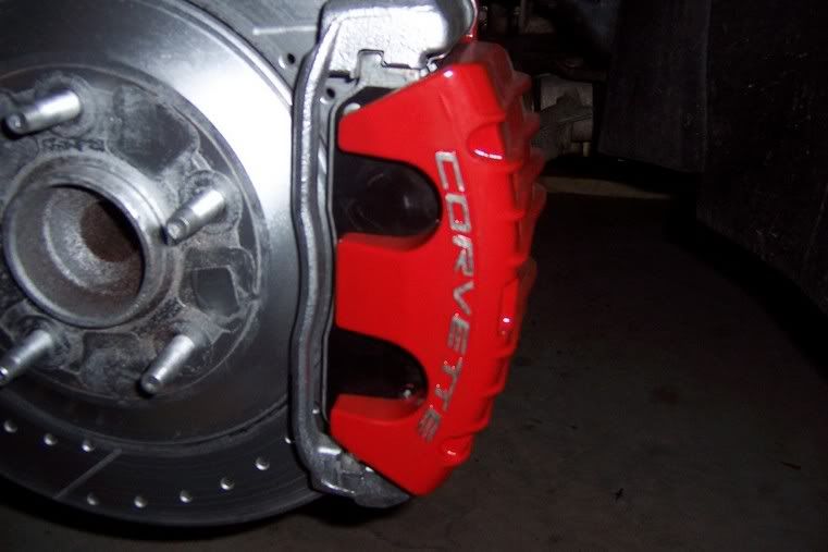

I used Dupli-Color. The color Red matched my car perfectly.
Took the calipers off the rotors and cleaned them at least 10 times with Simple Green. Covered the car and masked everything off. Sprayed 8 coats and the finish turned out like glass. So far the finish is still perfect after 2 years. Friends of mine who own Corvettes always complement me and asked if I purchased them that way or had them professionally done.
Tip:I used a Chap Stick and covered the Corvette letters then sprayed. Afterward I used and sharp utility blade to slice off the Chap Stick. Do not use you finger to rub the Chap Stick off because it will smear the paint onto the letters.
