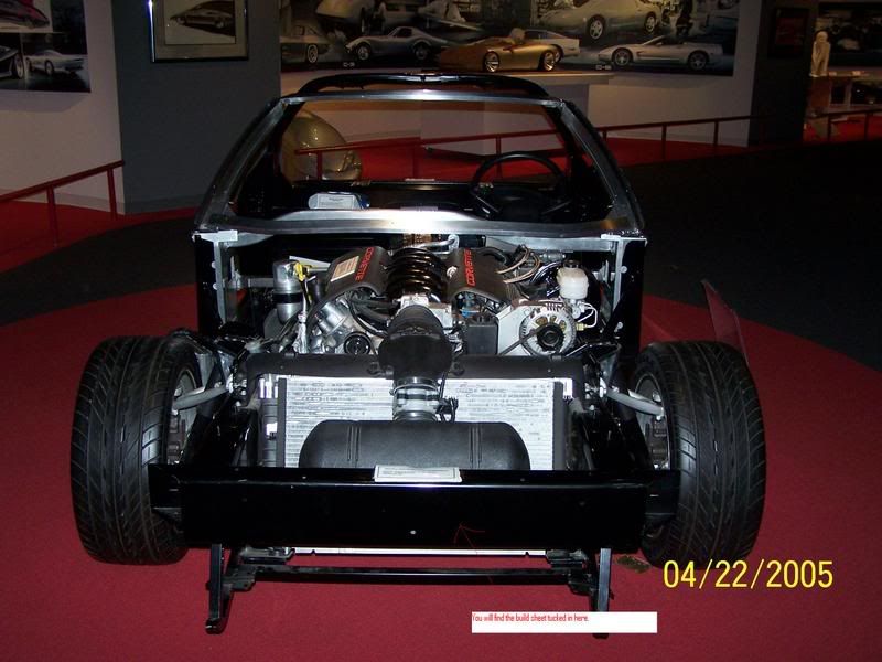

The build sheet on the C5 Corvette is placed in the Reinforcement bar behind the front fascia. You will need to remove the front fascia and front bumper assembly to get at it.
It is in the black bar that you can see just to the left of the date.

Nice pic Paul

Looks like i'll be getting one from the museum then!

That is where I found mine due to bumper cover replacement.

I grabbed mine back when I installed my tigershark nose. You 100% must have the facia off because the foam absorber has end caps that cover the open ends of the front crash bar part of the frame, and this is where the build sheet is.
