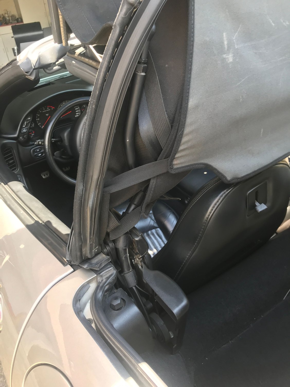

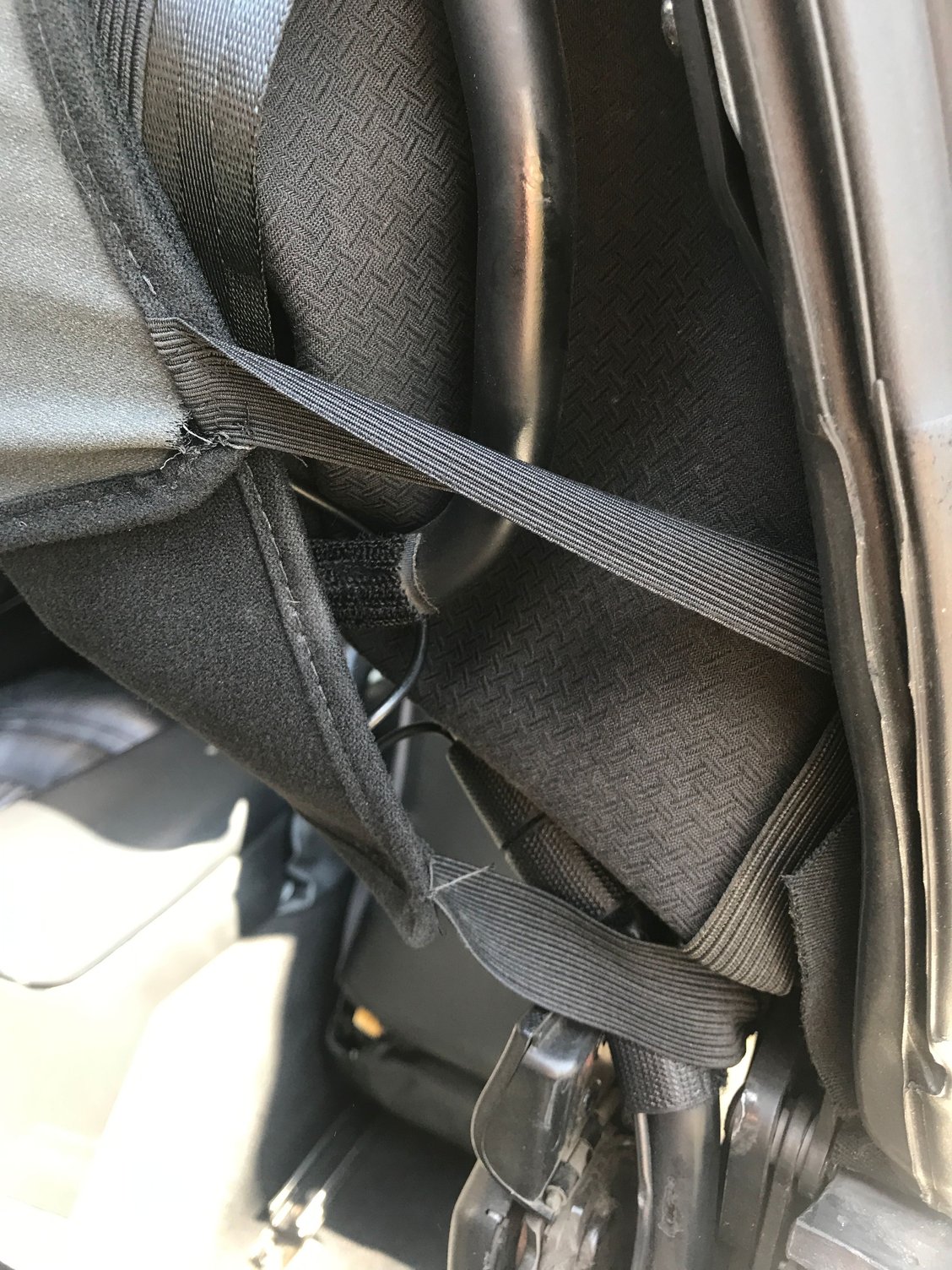

I had the same flapping on mine. I looked and saw a 1" x 6" strip of elastic that runs from the front edge of the flap to the frame of the top that was sorely stretched out. I carefully unstitched one end and unscrewed the other end from the frame and replaced it with a new piece. Viola, no more flapping. My sewing was a little rough but it worked fine...
