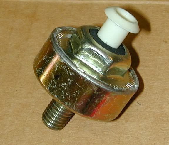

Pretty easy, actually. There are two in line in the valley cover under your intake manifold. You can see the two black plugs for the knock sensors in the pic here.
Pop one off and very carefully pull the connector off the sensor - they are a bit finicky to get off.
Plugs off.
Use a ratchet with extension to unscrew the sensor and install the new one to the prescribed torque. Here's what the sensor looks like.
I can send you the procedures you need to do this swap if you send me your email addy.

I noticed you had a '98. I also have a '98. Just a FYI, there are two different types of sensors that were made in 98. I forgot the difference exactly but it has to do with the electrical connector. I'm pretty sure the one I have has a "tab" that is not pictured in the pic Patches posted above. I'd recommend taking out your sensor first so you can compare the new sensor.

The procedures I sent are '98-specific. There were actually 2 knock sensors listed in '98 - one with the tab and one without. The knock sensor part numbers for a '98 are:
With tab - 10456222
Without tab - 10456603
(Please confirm these numbers as they are difficult to read in the parts book.)

Does anyone know what they should be torqued to when reinstalling? And someone mentioned one having a tab and one not. Which one is which and are they specific or can a non tab be used in place of a tab or vice versa?

13 lb. ft. - it's in the procedure I sent. When you remove your sensors is probably when you'll find which style sensor you have since your model year has both styles listed - see my post above.

I have a new knock sensor, GM#10456222 without tab, just like the picture Patches posted, that you can have. I ordered it for my '98, but it was the wrong one...so I had to order the one with the tab. The dealer couldn't tell me which part number was the correct one, even with the VIN #. If this is is what you need, PM me you address and I'll mail it to you.
