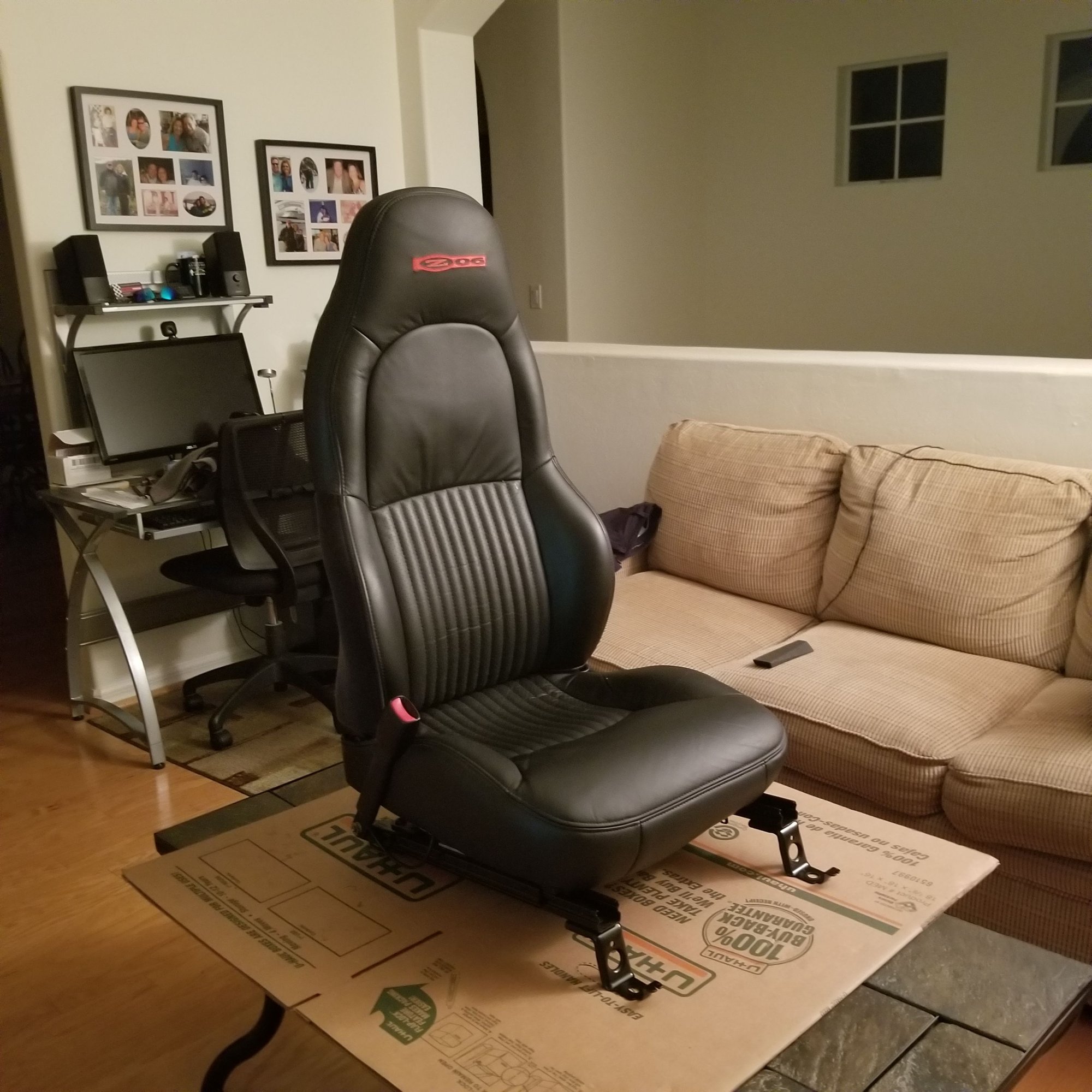

I know that this is an older thread but I just got the car. I set key 1 according to the directions in this post and the owners manual. It remembers the mirror position but not the seat. Any suggestions are appreciated. All the seat controls work when you manually push the buttons. Thanks...
Old Aug 12, 2024 | 04:44 PM
Quick7's Avatar
Quick7
Joined: Jul 2020
Posts: 44
Likes: 12
From: Florida
All fixed. Since I'm not the original owner I didn't realize that someone along the way removed the memory module under the driver seat and replaced it with a cheaper non-memory module. Simple replacement of the correct module and the seat works perfect. While I had it out I corrected that situation with the seat moving back and forth due to the shims being worn out in the track screw... I was able to do it all in air conditioned comfort too...
lol.
