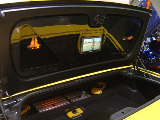

When it comes to the C5 convertible the ONLY solution for good sound and still retaining decent cargo space is this set up...As we all know when the top is down cargo space is even more limited......I can still stow items in the center cargo area, as well as stack a suitcase or two on top of it with the lid in place ...

I have the amps now placed behind the seats but in roof stowage area (think between seats and roof when top is down). I'm having boxes made similar to what you have except they'll be custom fit to go from the corner of the center storage well to the end of the wheel well. This will accomodate two 8" subs (could prob do to shallow mount 10's but this is enough for me). They'll be held in place with velcro to allow for easy removal...just pull out of the corner, disconnect speaker wire and remove. It will allow me to use the center storage well, too. I'll sacrafice the two smaller storage areas but I'm cool with that. Then I'll have all but about 1.5-2 sf of the trunk available when top is down. I'll post pics next week when it's done.
