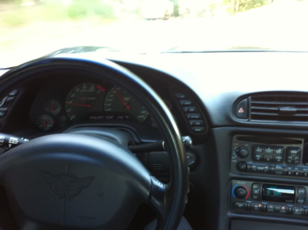

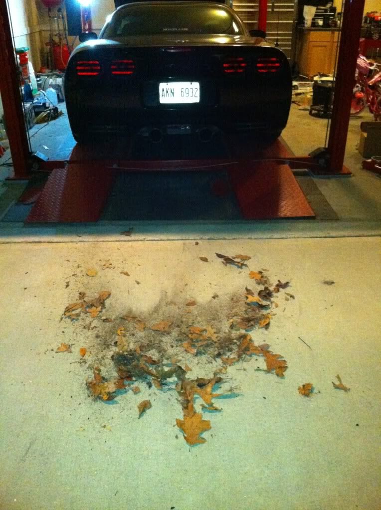

I am a lazy S.O.B. and finally got around to cleaning out the radiator this weekend after the car just about melted. This is a common issue that plugs the radiator and chokes that already crappy fans, causing the temps to get crazy.
For those who don't think that cleaning the crap from your radiator wont make much difference, here is the proof.
Before (it would continue to get hotter until I'd shut it down at 250+ DEGREES coolant and > 245 degrees oil):
Pic of the offending junk. Seriously, THIS ALL CAME FROM THE RADIATOR!
and the happy cool car (in the stank Georgia heat too!!!). I have the fans set at 190 and a 160 stat in.

I found the perfect tool too, you know that infomercial for the windshield cleaning wand? That thing works really well for getting in between the radiator and ac condenser! Keep in mind that the radiator is behind the condenser, and you will want to at least remove the intake bridge, shroud, etc and dislodge the radiator for a little wiggle room.
I had other things to do so I removed the entire unit, but you do not need to for this.

I used compressed air w/ a wand and got even more that that out at 17,000 mls. Couldn't believe it. I then put a protective screen across the bottom intake to reduce the big stuff. But the sand and dirt was unbelievable!

Recently when I replaced my water pump, I blew out all the small stones from both the condensor and radiator. What a pile that I ended up with, unbelievable.

Not if you go from the inside out. I removed the fans and am able to access it from the back side, pushing the debris back out the way it came in.
