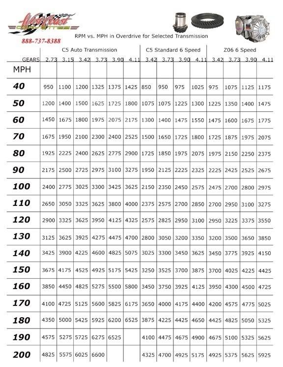

Here you go Tom.
If you do a lot of highway driving I wouldn't go lower gears, I would look for another exhaust system that would get rid of the drone.
Here is an rpm chart that will give you an idea of rpm and gears at different speeds.
Mr.Bill
Hope this helps.
