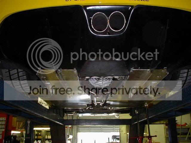

From: Arizona
Originally Posted by AU N EGL
how about a race version ?
one that goes under to the transmission to close off the under side AND has two or four channels ?
like this:
I am with AU N EGL.
I like this loook, however you make it, please please please do not make it look cheap or like a cosmetic POS.
I contacted this company and I think it was Blackdog Racing (but not 100% on that) and there didn't seem too interested in making a second one. But like AU N EGL, I downloaded these very same pics as a motivator. Unfortunately, no one ever made anything half-way decent. The BPP diffuser looks horrible. (IMHO) and it doesn't match well with the C5. Now, their C6 diffuser looks pretty radical, but how many Vette owners have center lined exhaust pipes.
Whatever you do, do NOT make any silly holes for exhaust pipes to stick through. Just use a concept like the C5-R, o rlike that poor photoshop attempt above on the red Vette. Straight, flush, fins, and make it curve underneath to be more useful. Oh, and lightweight.
Old Mar 6, 2012 | 11:53 PM
  #57
TriplBlk's Avatar
TriplBlk
Joined: Jun 2009
Posts: 3,888
From: Frederick, Maryland
Everyone has got to keep in mind, to have a fully functional you have to have the underneath of your car plated with channels.
"The book is called: "Race Car Aerodymanics: Designing for Speed" by the aforementioned Joseph Katz... I also have read it several times and realized that most rear diffusers are really for looks, not effect. Unless the entire underbody is given the aero treatment, the airflow under the car is too turbulent for a rear diffuser to have a noticeable effect. Most of the "supercars' that have effective rear diffuser aero also have flat bottom panels and mid engines. The mid engine design also makes doing the flat underbottom thing much easier from an engineering standpoint. The picture here is the Brian Glover Design "feeder" panels for the rear diffuser. I'm guessing this is about as good as you could do for a streetable car."
IF you want this fully fuctional...
Just thought Id make everyone aware
