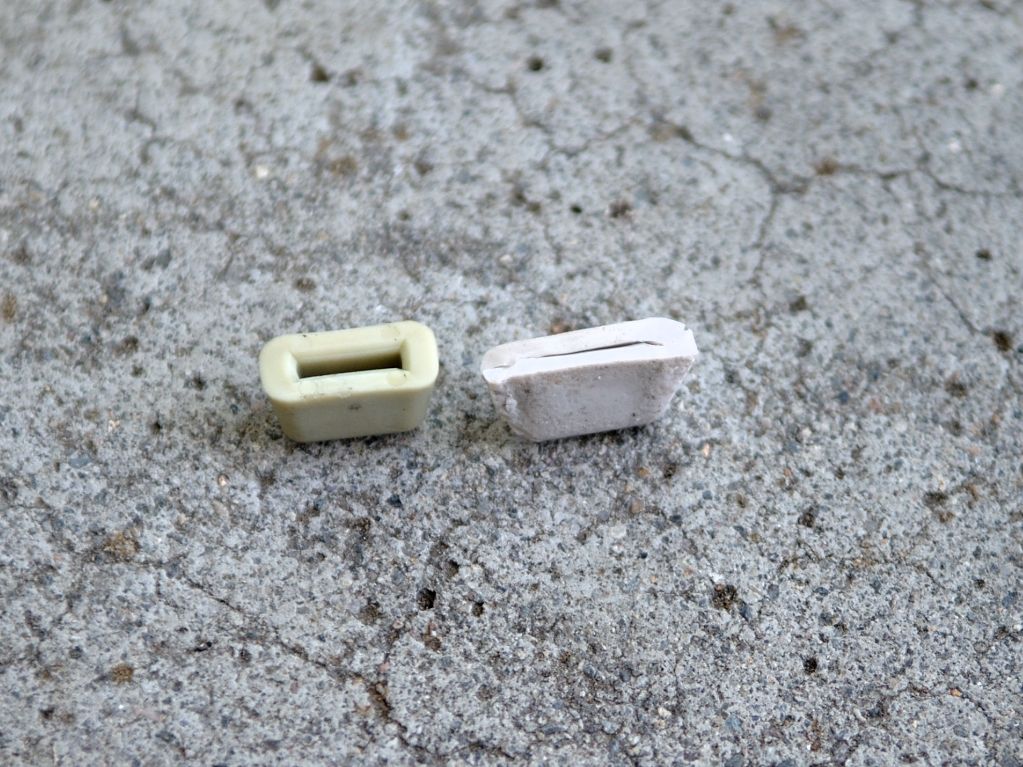

I did a test, I had 1 new one from another forum vendor and the set from another website.
What I did just to see how they will hold up under extreme pressure I hit both with a hammer a number of times just to see and the one from the other vendor was wasted when I got done and the one from another website was still like new.
http://rodneydickman.com/catalog/pro...roducts_id=309
Here is a picture of the 2 I hit with the hammer and you can see the one on the left wasn't phased at all and the one on the right didn't hold up at all.

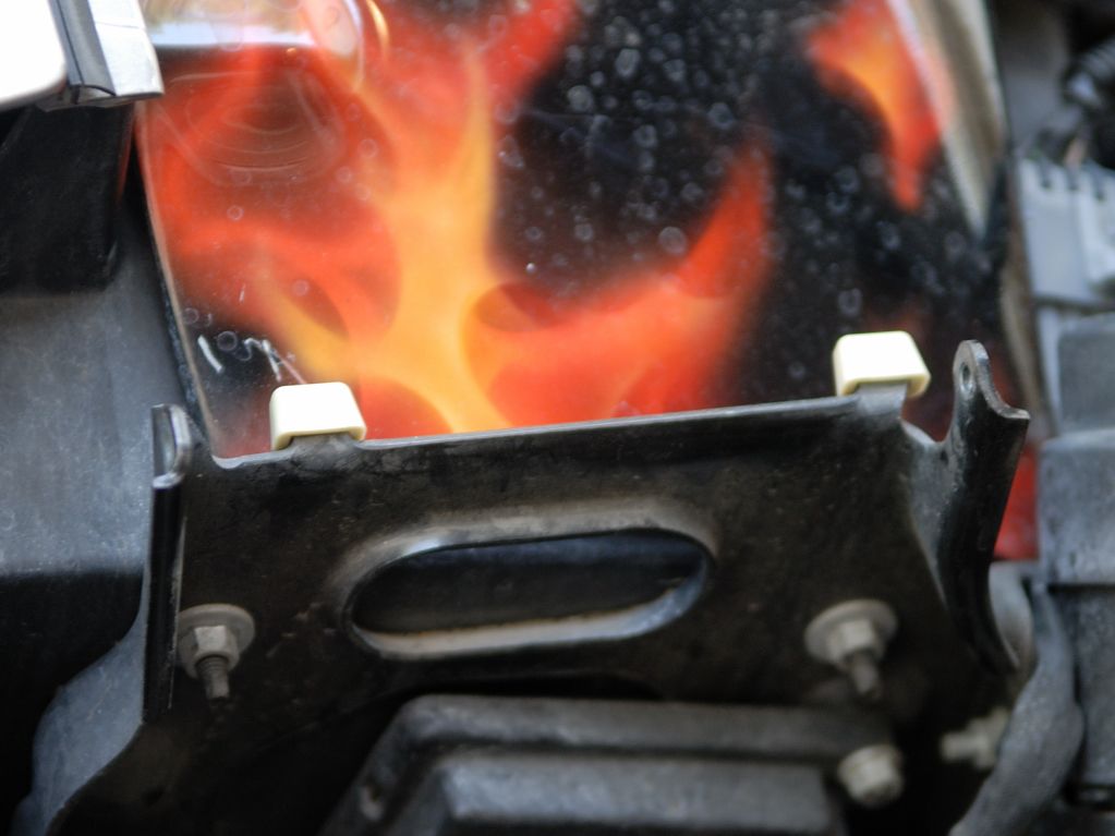

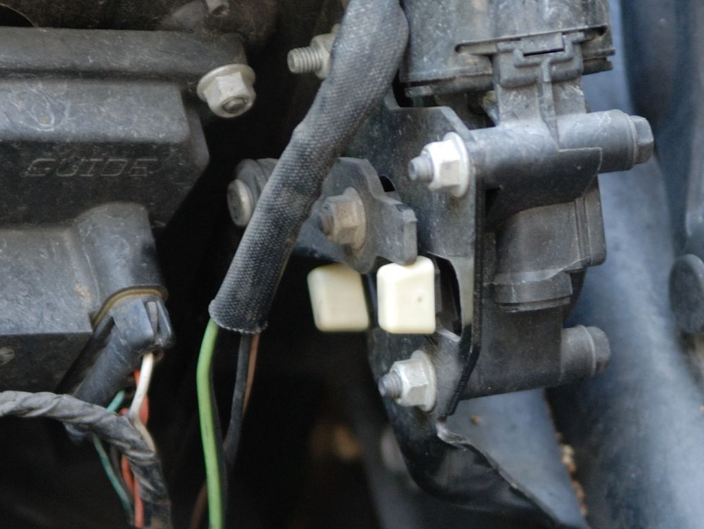

Here are a couple of pictures of the new set installed, They are a perfect fit and best of all when my lights are open I have no movement.
Another great product from another website, I also have his Headlight gears on the Vette and the WS6. No issues at all.

Stock motor with ACA lamps. When my headlights were in the up mode I could grab the headlight and had some up and down movement. No longer do I have that.
