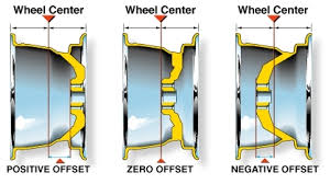

Offset describes where the hub is in relation to the rest of the wheel.
Stock Z06 offsets
Front - 54mm
Rear - 58mm
Old Sep 6, 2013 | 10:29 AM

This is why offset is critical ... especially if you plan on putting wider wheels and tires on the car. The offset and width of the rim will determine how close the tire is to suspension components etc on the inside surface of the tire, and it will also determine how far the outer surface of the tire fills up the wheel well, or sticks out beyond the fender lip.
http://www.tirerack.com/wheels/tech/....jsp?techid=95
