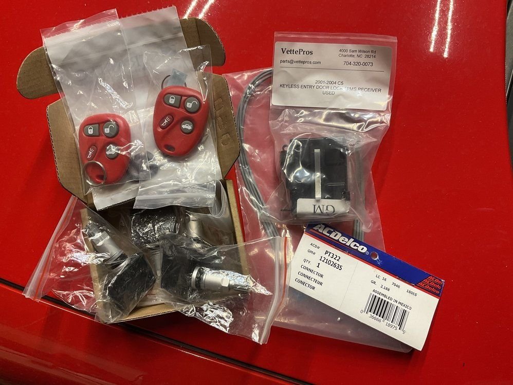

Yep, here's my thread on it with all the details
https://www.corvetteforum.com/forums...01-04-wow.html
Here's the threads I used to figure out the wiring and everything else
https://www.corvetteforum.com/forums...e-sensors.html
https://www.corvetteforum.com/forums...-and-fobs.html
Basically you need the newer fobs, the newer TPMS receiver, the TPMS wire harness and 4 of the newer TPMS modules that you program to the new TPMS receiver BEFORE you have a tire shop mount/install them in your wheels.
It's not a completely simple conversation and you'll need to source some parts but it is well worth the swap in the end.
Hit me up if you're serious and I'll help look for the parts needed online as they're not manufactured any longer and you'll need a donor car
