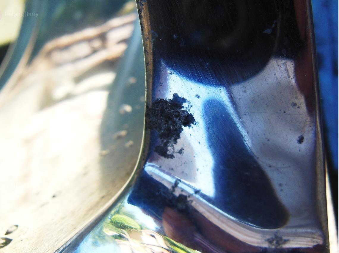

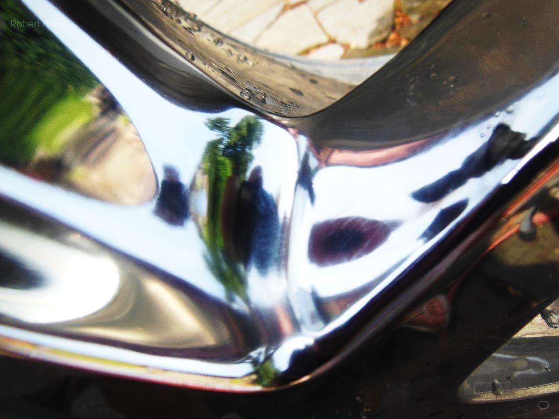

Some Forum members are inquiring about the black oxidation marks that show up on the front parts of the rims. Once the clearcoat breaks down, oxidation will soon follow. The most common oxidation appears as small (or large) black specks or dots, especially in the corners of the mag struts. These cannot be polished away - they must be sanded out. If you follow the same steps outlined above and remove the clearcoat from your rims (as I did) you will be able to remove the black pitting and completely restore a showroom mirror shine. I have attached photos of a nasty corrosion mark that I had on my wheel (about quarter size). Again, AFTER the clearcoat is removed, I used 100 grit sandpaper since this was really nasty area of corrosion. For the smaller specks, you can begin with 180 or 280 and move up through the grits from there - again, following the above steps. If you look closely, you can see hairline scratches on the rim. These were caused by scrubbing the rims with a nylon brush (my bad). These lines were also completely removed once I finished the sanding and polishing. Obviously I use a soft sponge to wash the rims now! Good luck.
Some members have wondered whether it's worth the trouble of removing the clearcoat since you will need to polish the rims instead of simply washing them. Here are two photos which compare what my factory clearcoated rim looked like with the factory clearcoat and after removing it. You be the judge. I will say that I haven't found it a "burden" to polish and wax the rims every now and then to achieve these great results.
