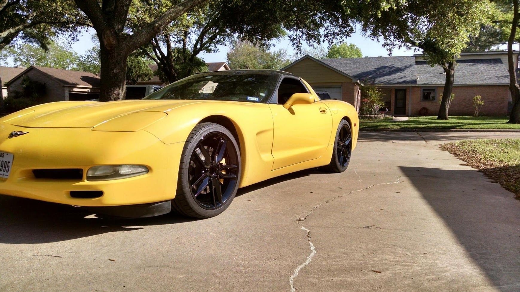

I know this is an old thread... But it is one of the ones that inspired me to put OEM C7 Z51 rims on my C5.

Originally Posted by Floridasky
Does not do anything for me.
They make a chrome version for those who like to clean wheels a lot. Of course if you don't like the double spoke design there is no hope for these wheels sexing your brain.
I like the gloss black because I can let the brake dust layer up and everyone thinks I have matte black wheels instead of thinking my rims are crazy dirty and I am too lazy to scrub them.
Your garage is pretty sweet and your C5 is in the best Corvette color ever made!
Old Mar 28, 2016 | 10:48 PM
5150RN's Avatar
5150RN
Joined: Nov 2014
Posts: 276
Likes: 6
I was wondering if you use any spacer for the z51 wheels. Are they OEM? I want to do the same. Very nice looking.
Old Mar 28, 2016 | 10:54 PM
Internetguru's Avatar
Internetguru
Joined: Dec 2015
Posts: 1,120
Likes: 132
From: Houston TX
Yes OEM C7 Z51 wheels and tires. Used Doug Rippie Motorsports aluminum 5/8" spacer and replaced the stock studs with 2.5" ARP chrome molly racing studs and gorilla track style lugs.
https://www.corvetteforum.com/forums...w-2004-c5.html
To C7 wheels on a C5
Old Mar 28, 2016 | 11:03 PM
5150RN's Avatar
5150RN
Joined: Nov 2014
Posts: 276
Likes: 6
Did you use the ARP studs and spacer for rear only or for the front too.
Old Mar 29, 2016 | 07:45 AM
Internetguru
Joined: Dec 2015
Posts: 1,120
Likes: 132
From: Houston TX
Rear only. The fronts fit perfectly with no changes.
My car was originally slammed to the ground and was raised back up to near the stock height to make sure these clear everything. I also wanted to have something called suspension travel. Was tired of shaving bits of my Corvette off when going over aggressive speed bumps.
http://dougrippie.com/featured/drm-wheel-spacers/
Doug Rippie Motorsports 5/8" spacers
http://dougrippie.com/products/drm-extended-wheel-studs/
2.5" ARP Chrome Molly racing studs
