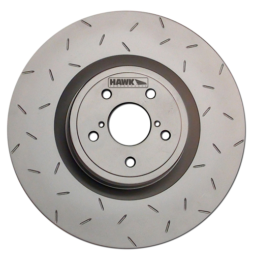

Virtually all factory racing teams use slotted-only rotors, with may using designs similar to the ones shown above. Holes are well known to be susceptible to cracking and are considered only "Bling", just as most giant rear spoilers are.
Hawk makes rotors that have a "chicken feet" pattern of slots that also similar, as are the famous J-hook slots that AP Racing uses. While I have the old school straight slots, if I were buying, today, I'd opt for one of the two I just mentioned. Slots keep the rotor cooler and the pads, parallel to the rotor's friction disc surfaces. With the newer slot patterns, hot spots in the rotor are less likely to happen.
Hawk Quiet slot:
AP Racing J-hook:

Anybody tried out a set of these Hawk Rotors yet? I didn't see where they had an application for my 94 Z. They aren't zinc coated either so I wonder how they'd hold up?
Have you looked at AP Racing rotors? They may be 2-piece and fairly expensive, but I'd guess they are high quality pieces.
While I haven't tried the Hawk "Quiet Slot" rotors yet, I do have one at work for a newer Miata. We had been experimenting with various slot designs and I bought the Quiet slot rotor to look at. I've had it for quite a few months and it is definitely not rusting. I can see that it has some type of coating - maybe zinc.
We coat stainless steel rotors. They are at least 6x stronger than cast iron ones.
