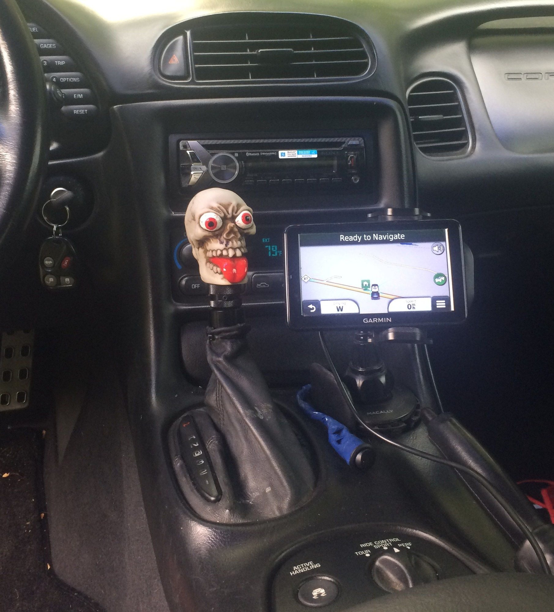

Installed my adapter today, it was as simple as everyone said. I had a little trouble with mine in that the hole was drilled up into the adapter where the ball goes on so the rod would not push far enough down to come out of park. I clipped some zip tie pieces and filled the hole allowing it to push down far enough to come out of park. Works great.
