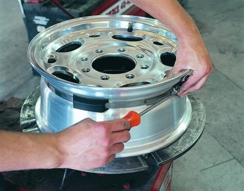

The banded TPM sensor is a sensor that is secured to the rim well with a worm-drive band clamp.

If it was glued well, you probably couldn't take it off if you wanted too without wrecking it.
The bands are not cheap, and a pain anyway. If it did fall off you might hear it at slow speeds, and when moving it will just be stuck to the tire until you stop. Would also feel vibrations come and go too. Seen a lot of installers break the band removing, or worse install the tire and not even know they broke it. There are quite a few wheels that a valve mounted sensor wouldn't fit.
I can see where the "and glue" comes in: I'd want something to keep the whole thing from slipping around and throwing the wheel out of balance.
