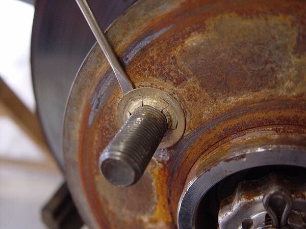

One more thing. Make sure you removed the OEM press-on clips from the wheel studs before installing the new wheels. These clips are installed at the factory to keep the rotors in place during assembly. The OEM wheels have enough space to clear them. A lot of aftermarket wheels do not.
This pic is not a C5 but just for illustration purposes:

100% get rid of those clips if you have non-OEM wheels.
The wheels won't sit flush against the rotor otherwise.
[/QUOTE]
Those clips were on all four of my rotors. Have you ever done the brakes on the car? If not this could be the first place to look. Clips will not allow wheels to sit flat on the rotor hats.
