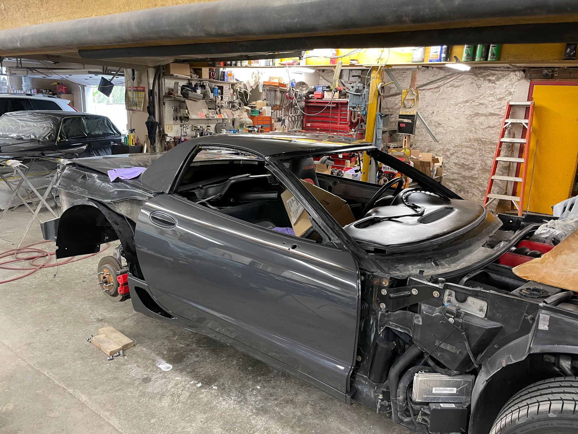

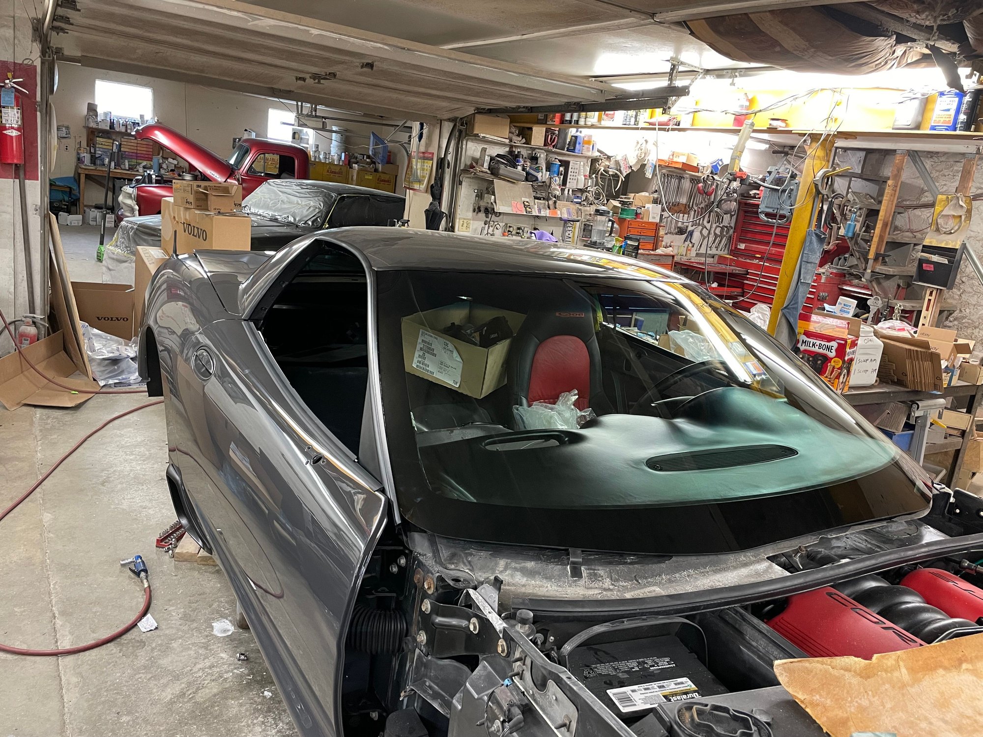

You certainly can salvage the old molding (being extremely careful), but given the age of the C5 replacing is a good idea if you can source the parts. Here’s a before / after to get an idea.
