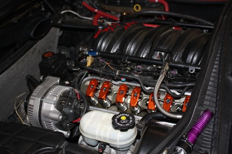

I can also join the club now. Tuner called today with dyno results...although they were ran on different days, I gained a whole whopping 16/11 rwhp/tq on a fast 102 from a stock ls6. That's with new 102mm TB and halltech intake. Was not worth it in my case. 452/410 to 468/421. I'll see the under the curve increase tomorrow when I pick it up.

Here is the "increase" in-case anyone was curious.
Dyno's were overlaid but performed at different times.
This is an un-ported Fast 102. Maybe someday I'll get to porting it.
Looks cool though!
