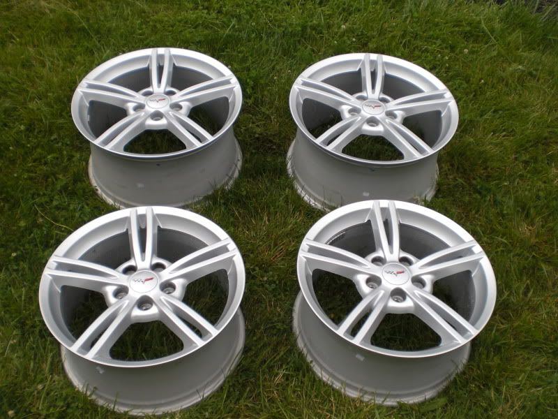

does anyone have pics of their c5 with these c6 wheels on them?
will they bolt right on? need spacers?
pair of 8.5x18” fronts and pair of 10x19” rears

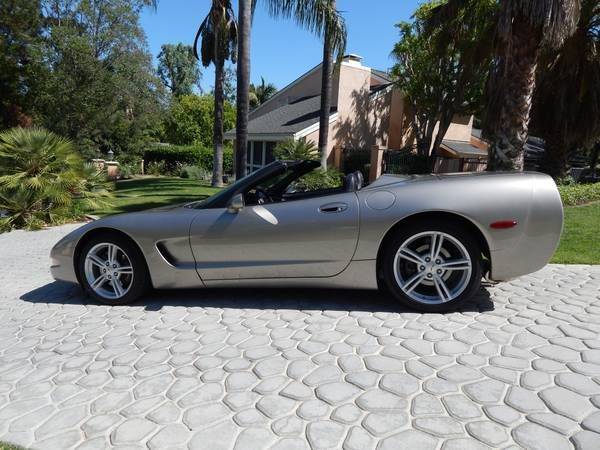

Had these on my car last year. Fronts don't need a spacer but the rears will need one. Factory C6 tire sizes.

The wheels do look good on the C5.
