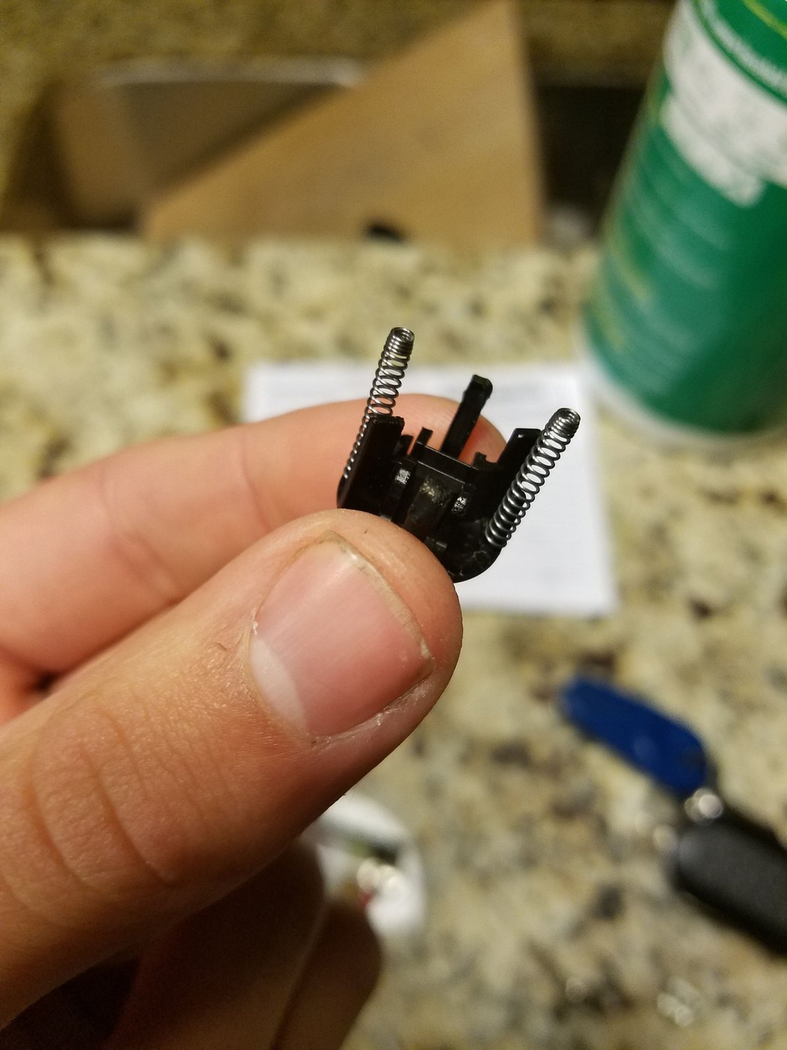

Alright boys and girls,
Just did this last night.

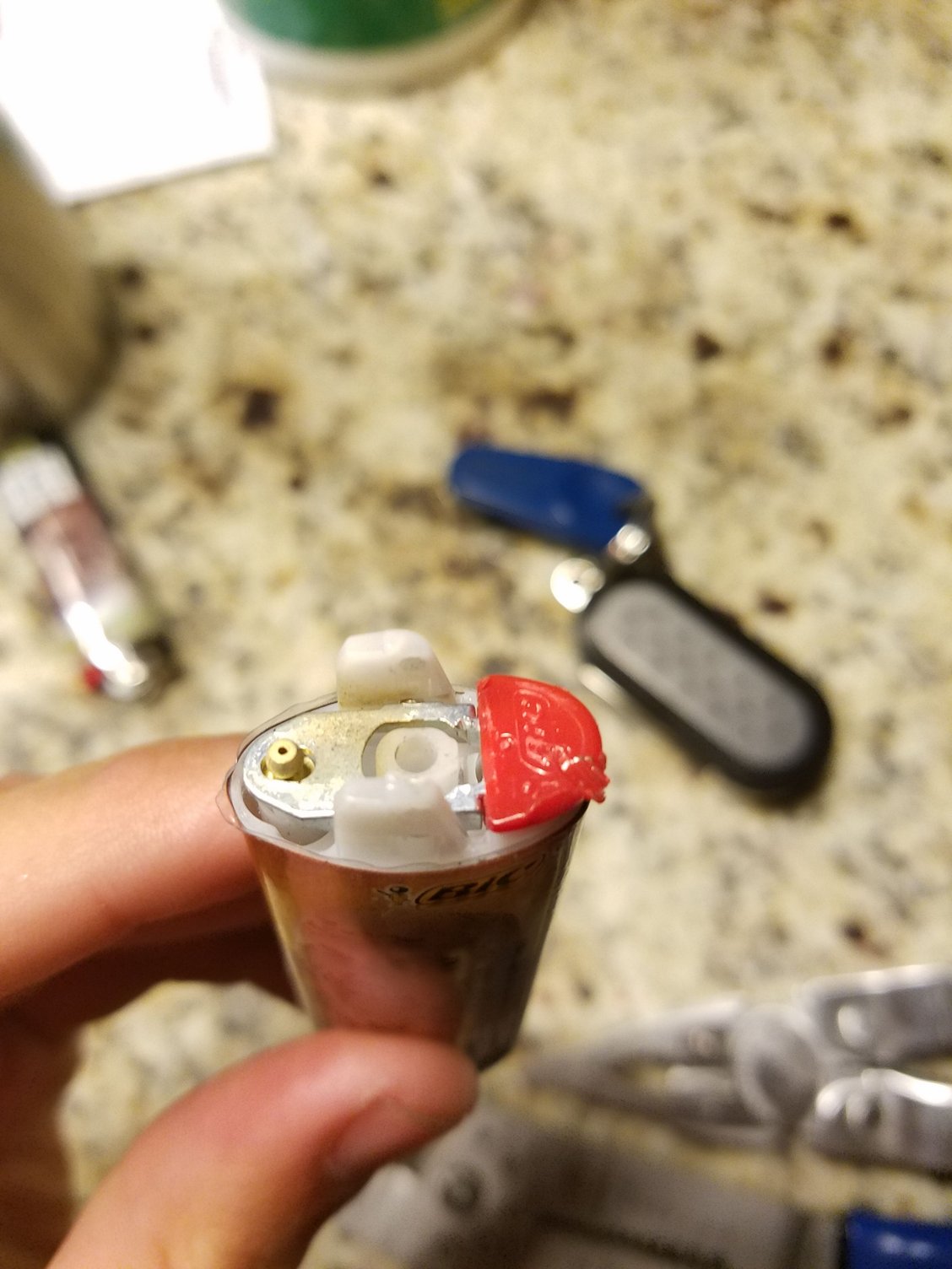

1. Destroy a bic lighter and remove spring.
2. Try to find one of the original springs (search floor board)
3. Cut bic spring to length using original as template.
4. Place to springs at the 12 and 6 o'clock position.

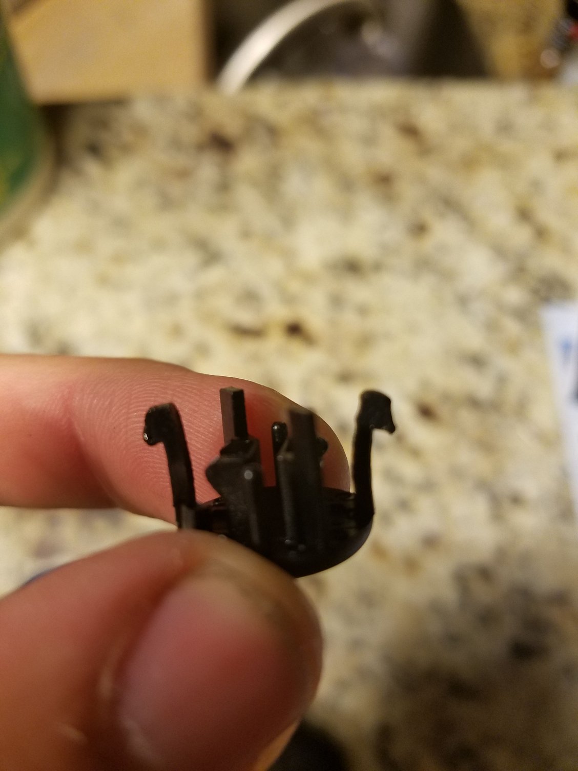

*on the button itself i very carefully flexed the two flanges at the 3 and 9 o'clock position so they would grab the inside of the stalk, careful not to snap them! a very gentle flex, or maybe a tad bit'o'heat.*
5.line up button and springs and insert!
6.Done. Dollars saved: approx $175.
Holla at me
Take some fire to these flanges, but only for a second or two and oh so gently bend them outward. (do this before destroying lighter)
spring in here
place springs on poles.
line up spring at 12 and 6 o'clock and insert!

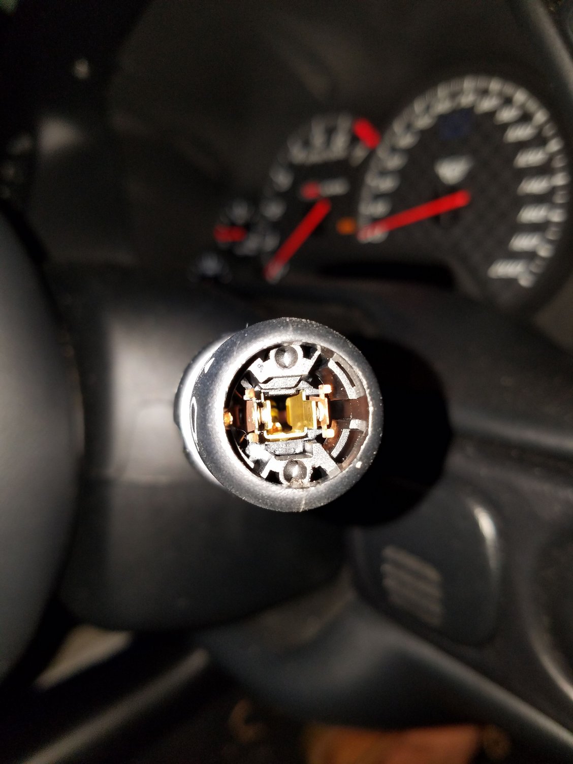

Had to revive an old thread, Went to turn on washer and button stuck in the pressed in position. The washer fluid would not stop spraying until I removed the key! The BIC lighter spring (beneath the flint) is a perfect fit and it is long enough you can cut in half to replace both springs! Thanks !!
