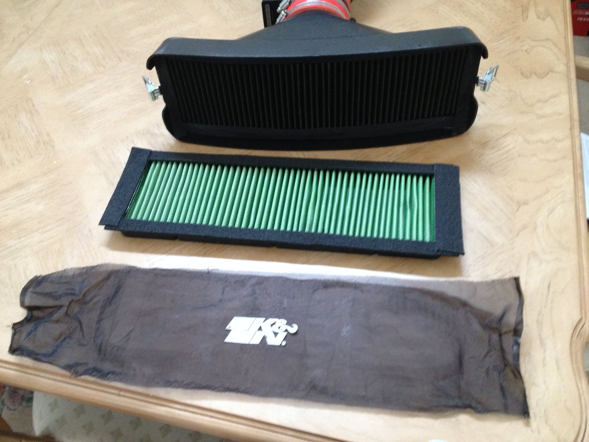

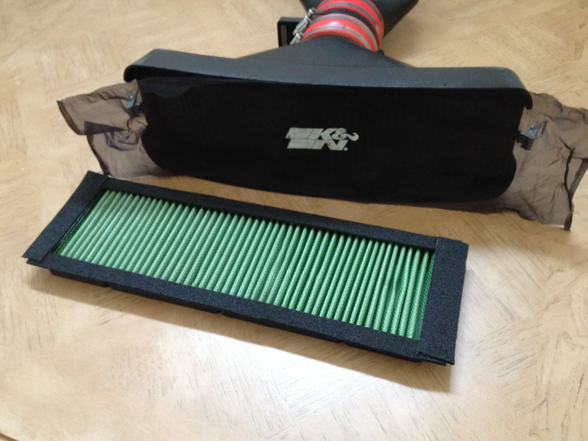

To the op or anyone else. After I installed my vararam 3rd to 5th gear at WOT seemed to pull much harder. Especially 4th, with the stock unit shifting from 3rd to 4th the car seemed to just fall on its face, via sotp. With the vararam it just pulls harder above triple digits.
Though if your on a budget or wanna try some type of free cold air intake try the zip tie mod. Before i installed my vararam I had the zip tie mod it helped better then stock. But the vararam helped more over 100+mph compared to the ziptie.
Also I will say the vararam does have a poor seal if you don't set it up right. I modded my intake with some waterpoof glue and some gaskets. I also added a k & n dry charger to keep hard dirt, grit and bugs from sticking onto the pleats of the filter and entering the motor. It also might help out on some water droplets but not puddles. With or without the drycharger it still pulls the same. I just like that its less work cleaning the filter.
