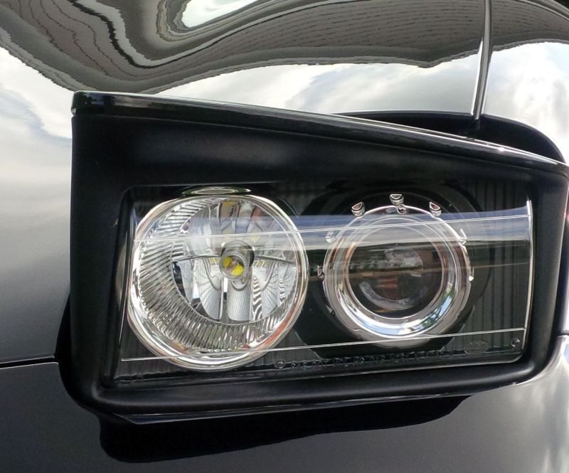

I'm pretty sure those are just projector housings with/without halogen bulbs. No HID bulbs or ballasts, etc. Contact the seller if you're looking for HIDs and ask if they are included (with ballasts). Cheapest I've seen for true ACA style housing w/ HID replacements is around $300.
The other thing is I am positive you will get no support from the seller to hookup and install these housings and they likely come with a harness that needs to be installed.

It looks to me those cheaper HID kits do not change the headlight lens.
The problem with having a stock lens and a HID bulb is that the lens doesn't spread the light correctly for an HID light. Ever notice that cars with factory HID lighting have clear lens. That is not a fashion statement. The clear lens spreads the light differently than a faceted lens.

You don't get the proper cutoff focus for HIDs with those, just big round beams and the high beam is lower than the low beam!
May as well run them backwards.
Also the Angel Eye halo ring casts a round yellowish addition to the beam
if you run it.

This is correct. There are 2 distinct types of housings like what you're seeing. The cheaper versions with the angel eyes or the flat-faced chrome trim on the projector are made in china.
1) The plastic used in the lens of the Chinese version creates an optical distortion in the pattern which blurs the cutoff. The center of the pattern is more of a "blob" of light and this requires aiming the headlights much lower to reduce glare to other drivers. This defeats the purpose of having projector optics of any kind and causes you to loose a significant amount of vision.
2) The Housing material is significantly weaker in the Chinese version with several customers reporting that the mounting points broke during installation despite suggestions to be extra gentle when mounting.
The other style of lights (with the textured chrome trim ring) is a direct copy of the original ACA headlights made in Taiwan with an H9 bulb in the projector. These housings are far more durable and optically clear. These kits are rarely sold with the HID kit.
With both types of headlights, the projector low beam and high beam are NOT correctly oriented with each other. This means your high beam may be pointing either in the clouds or in the dirt when you low beam is properly aimed.
The Bi-xenon Headlights offered by Radioflyer Innovations are the top-shelf variant of these headlights. We use the high quality Taiwan housings with Bi-xenon projectors (these projector have a low and high beam mode using the same bulb) We use a Cree 16-LED High beam bulb in the high beam location. This gives instant color-matched high beam to match the low beam.
Our system also solves the alignment issue with the high beam since the LED bulb projects a flood pattern instead of a spot pattern.
In addition, with most HID systems, the headlights will not lower automatically when turned off. Our kit includes a plug-and-play HID system designed to mimic the current draw of the factory bulbs resulting in the correct function without the need for headlight resistors.
Yes, our system is the most expensive, but it also is the best-performing, easy-to-install system available for the C5 and offers more light output than any other pop up headlight kit.

As someone mentioned earlier you get what you pay for. Last summer I installed the Bi-xenon Radioflyer ACA Projector Headlights. The difference from the stock headlights is startling.
