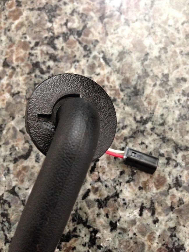

Does the sun visor bezel/round filler piece come off of the sun visor arm? I removed my visors but now want to fill the hole.
As you can see, even though I was as careful as can be, I mangled the little piece. If I get it off then I may wrap it in CF before I plug it back in.
Any other ideas for filling the hole left by the removed sun visor?

Ok, so I understand they come off. What's the trick? If I break these any further I will just by a couple from VetteNuts.

You have to take a small screw driver and try to pry each leg around the visor shaft you will see a small lip on each leg that holds itself to the shaft. I just did mine today came right off, a little patience is needed they were a bit of a PITA but they will slide off. then I just reinstalled them in the bezel and filled with my plug from lowes.
