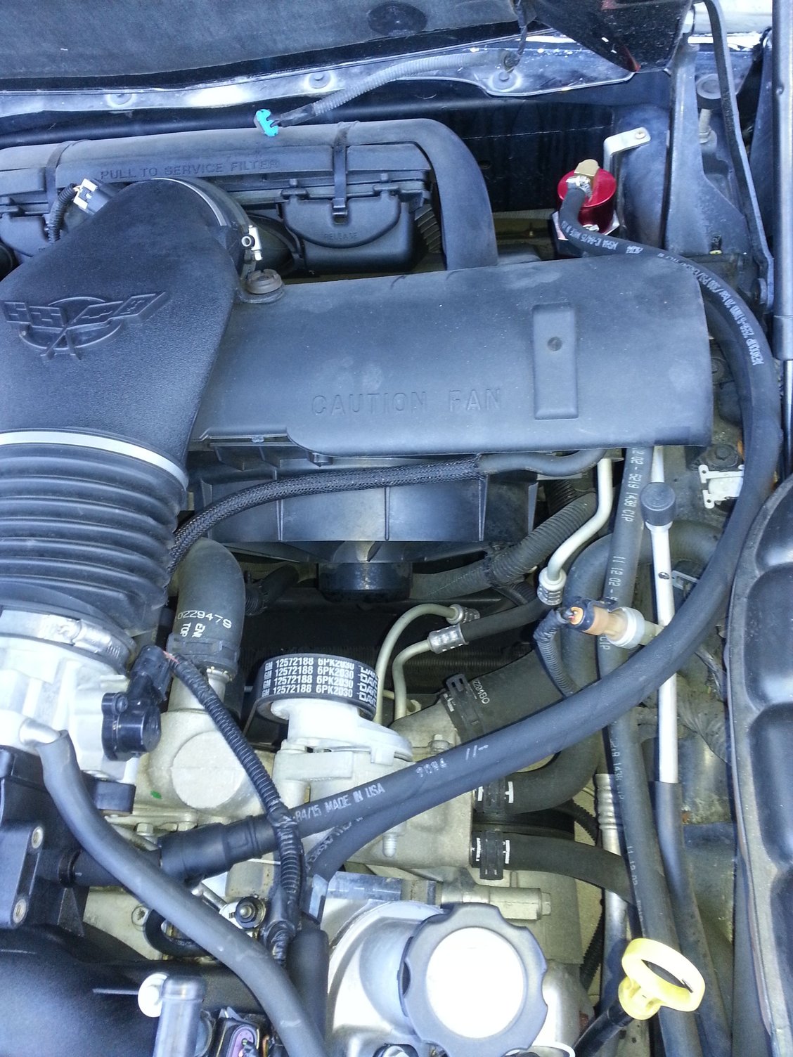

I check mine every 6 months or so.... However, my car is built and only gets driven to race or spirited weekend driving w my local Corvette club.... My set up....
Is mine set up correct? I looks to be different from your set up.
I have the main line going to the can and the top line pulling through the mesh filter and then PCV check valve into the intake.
The rubber factory elbow was rotten and blowing oil in the bay instead of the intake is why I got the can to begin with over a year ago.
I lost the instructions or the name of who makes this can.
Nice picture by the way.

bottom to intake, top to drivers side ( back of valley cover) Keep in mind there is vacuum pulling... so it is very important to have everything routed correctly. good luck.

Seems to be I have it connected incorrectly.
http://www.customcorvetteaccessories...lcatchcan.html
I have the pre LS set up at the bottom of the page.
