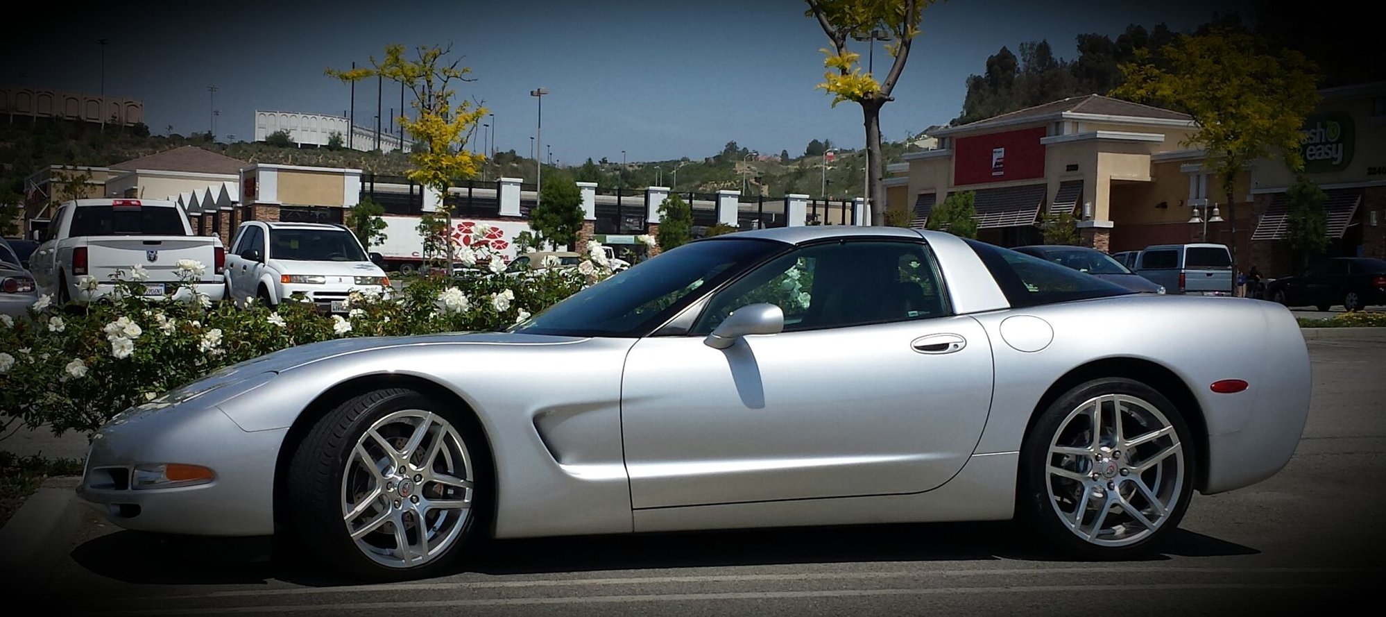

I went to 19 x 20 inch wheels over a couple years ago. No regrets at all. I get many compliments on my wheels, and how they look on C5.
To those who say larger wheels ride rougher, I say, it's just not true! I've had both. Corvette rides like a Sports Car, either way.
I think 18 x 19, or all 19's, or 19 x 20 all offer some good looks, and tire combinations for you to consider.
Mine are the 'machined silver' with clear coat; and I love the look.
Don

Those are absolutely HOT ! Great choice. What widths are you running and what tire sizes ? The setup looks fantastic !
