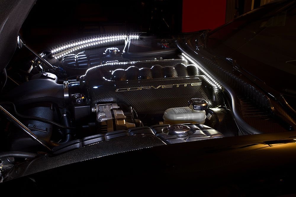

I also kept my Hood Light, but swapped it for LED array (older photos before the DiNoc)...

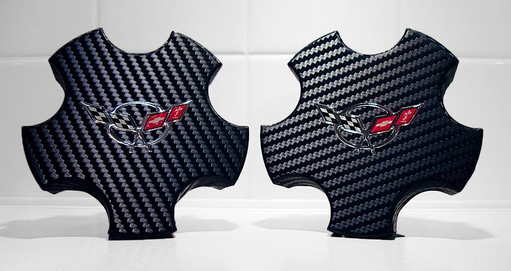

My interior... very close to the DiNoc look:
Also all my hydrocarbon parts get micro-scratches constantly which is a pain. Some parts like my Hydrocarbon Master Cylinder cover started cracking and peeling in the clearcoat, so I just removed it (may attempt DiNoc on that next, but that will be difficult to cover).
In my opinion, it would be very easy to get carried away with this material and overdue it to where it started to look "cheap" - too much of a good thing - I think it is better used as "accents".
