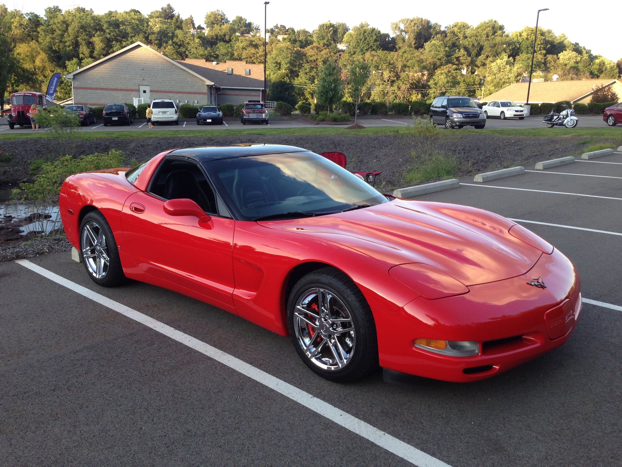

Aftermarket chrome C6 Z-06 wheels in C5 Z-06 sizes. Fitment, Front are the same, rear stick out a hair. the wheels are an inch wider then standard coupe wheels. Can't say what the off set is sorry. The sizes are 17x9.5 & 18x10.5 with stock size tires. nothing rubs.
Frank, Nice looking wheels. Quick question, by stock tire sizes do you mean the stock C5 (non Z06) sizes of 245/45ZR17 front and 275/40ZR18 back? Do those work on the wider wheels okay?

Yes they are non Z06 sizes and they do work fine with the wider wheel. 245/45/17-275/40/18.

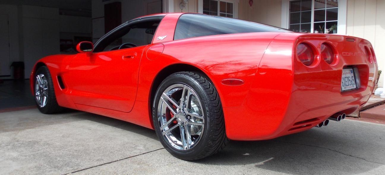

I went with chrome C6Z06 wheels in stock C5 coupe sizes........17x8.5" with 245/45/17 front & 18x9.5" with 275/40/18 rears.
Stock offsets are 58mm front/65mm rear. I went with 49mm front/50mm rear. This means my new rims protrude outward 9mm (approx 3/8") more on the fronts and 15mm (approx 5/8") more on the rears. These amounts are barely noticeable unless pointed out, but it does give a slightly wider, more "sporty" look.
