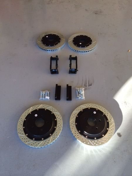

These are the pads I am using as well... Just installed them along with the Baer Eradispeed 2pc rotors.. Bedded my pads yesterday. Stopping is night and day compared to my previous slotted, cross drilled rotors.
