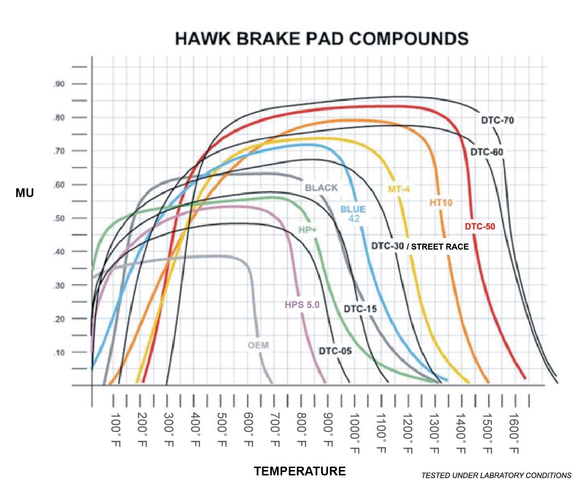

Did a little more research to see what's going on with Hawk's new stuff.
Looks like the 5.0 is the HPS replacement... supposed to have a better all around and have a better initial bite (one common complaint of the HPS).
The Street/Race pad is the same compound as the DTC-30, but has chamfered edges and shims to make it quieter. Probably designed as a replacement for the aging HP+, but based on the graph below, HP+ still has the edge in initial bite.
Street/Race pad looks like it might be a good pad for a dual purpose/compromise pad. I'd like to see how it compares to the Stoptech street performance pad.
