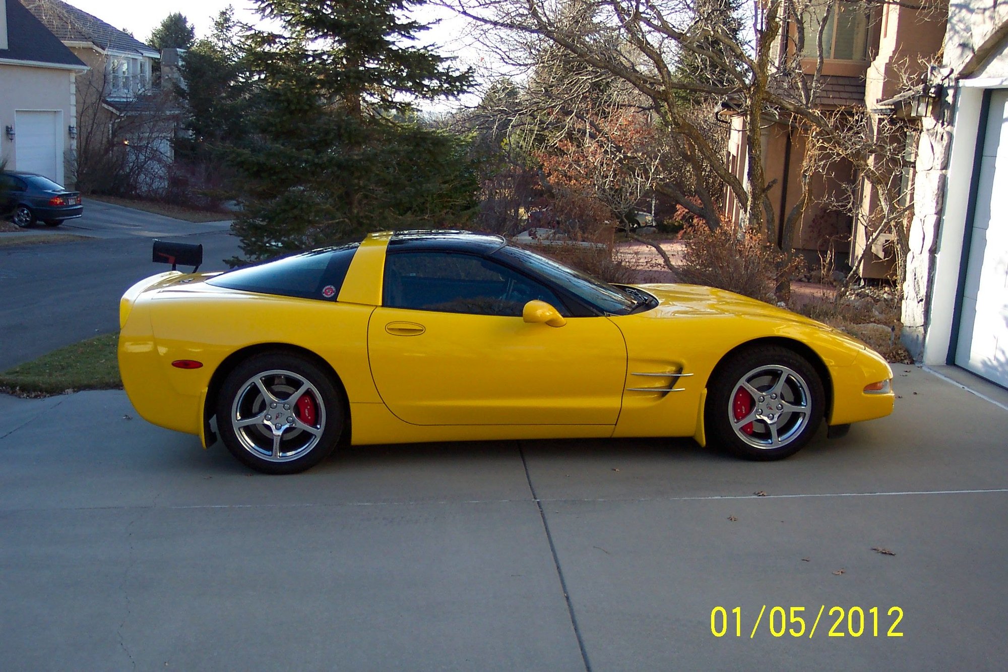

Although my serial number was in the range for the ring issue, I did not have it replaced. (R8C Aug 18, 2000)
I was not experiencing oil consumption at the time, and the logic that (eventually, maybe) needing to add a bit of oil once in a while was "better" than tearing down the engine for one ring to fix a problem I wasn't having.
Biggest problem on my 01 were the fuel senders.
Recently repaired the ECBM, and now need to replace all the weatherstriping.

Nice ride...

Sharp car!
