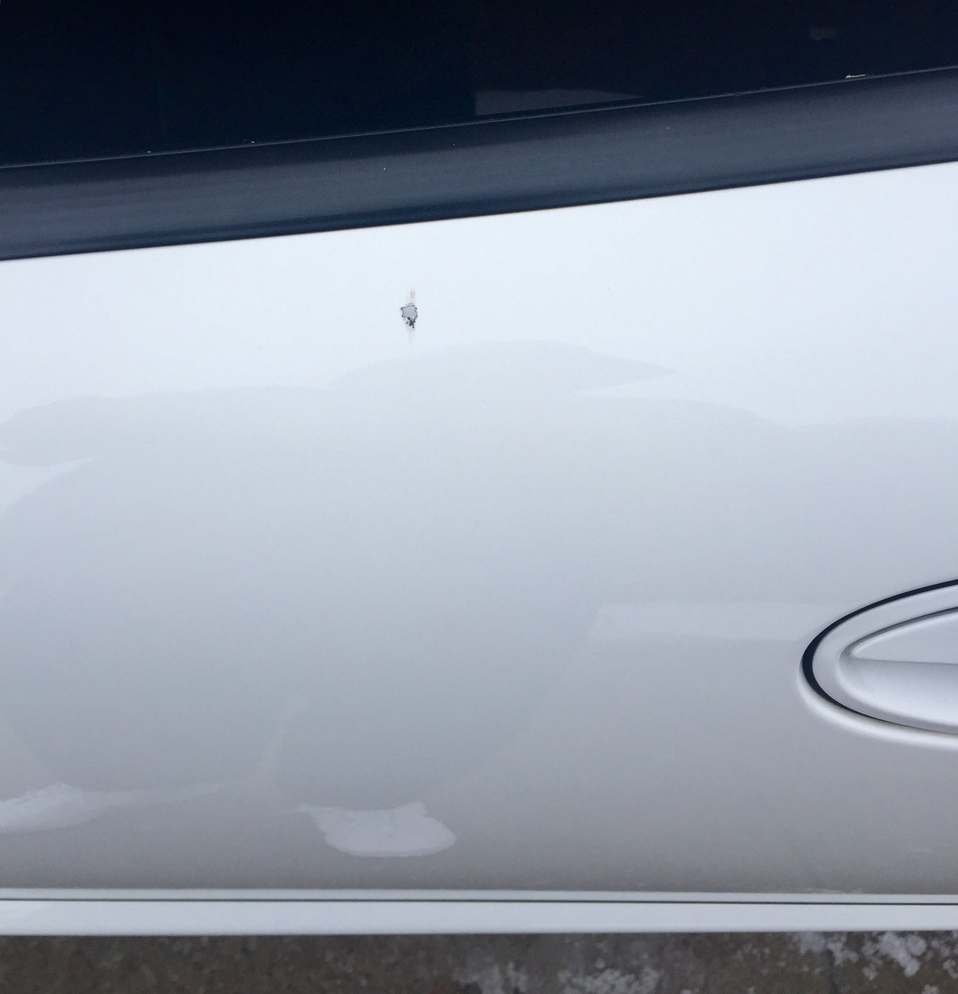

No use crying over spilled milk, time to move forward with best fix. I dropped a trailer hitch ball which landed on the driver side door by the window. The spot is about the size of a pinky tip.
Need recommedations for best fix. Is this something a touch up will repair or are we talking about a big job?

it looks like more than touch up, but a good body shop shop be able to fix it like new....if it helps. I know how you feel.. I've made a few boo boos myself.. it's Ok. It's not a heart attack, prostate cancer, or the IRS.

Not sure if it's worth getting some artic white touch up and trying myself or take it to body shop.

$500 to $1,000 from now and you will never be able to tell it happened.

I would try the touch up. White hides the repair pretty well. I did a lot of touch ups on my off white C3 and I was the only one that knew where my repairs were. If you drive your car it probably will get some more dings. Is it worth the 500 to 1000 bucks to you?

I think that is going to show pretty easily just doing a touch up. If it were mine, I'd probably take it to a pro and let them see what they can do.

Right now I don't think its worth 500-1000. I've ordered some proper touch up and clear from automotive touch up. I think I'll put some 2000 grit on the end of a pencil eraser and lightly smooth the spot. Then put some carnuba on the surrounding area to prevent overflow. Use some isopropyl alcohol to remove wax and oils from the spot itself. Mix the paint and clear coat and use a micro dabber to fill the spot until a slight crown appears. Once there I'll smooth with 3000 grit and then but and polish as required.
This seems to be the best DIY method after an hour of research.

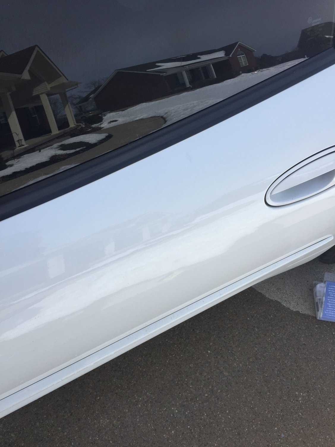

Good news is paint looks good otherwise! Don't often get a reflection on an overcast day on a white vehicle.

Touch up and a little wet sanding will diminish that! Try a Lanka or other paint chip repair product and see if you like the results. Good luck!
