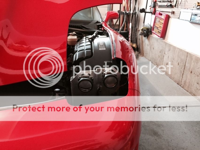

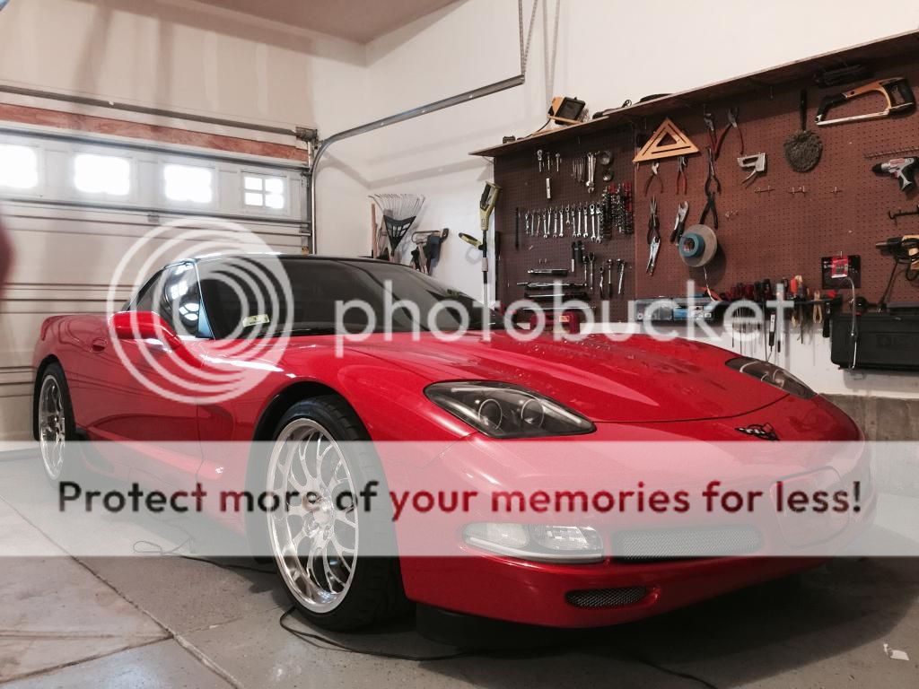

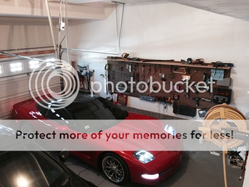

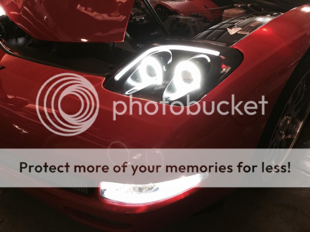

Finally got around to painting my shrouds gloss black so I could install my RF stealth cannon headlights. I added xbaled halos around each projector to ensure they could be seen during broad daylight. Haven't had the opportunity to do any night driving but I have no doubt the headlights will be a night and day difference over stock.
RF was very helpful along the way during my install when I had some questions. I couldn't find a lot pics of these headlights when researching so I figured I would add some pics for you guys to check out.

The headlights arrive deconstructed. IE, the lens, the shroud, projectors and mounting frame all come in individual pieces that you assemble after pulling your pop ups. You do have to cut your positive and negative going to the headlight motors, but easily reattached with a couple wire connectors or you could remove the wires from the pin of the plug if you're **** about not wanting to damage the car.
RF had mounted the 40mm light bars for me. I purchased 2 80mm xbaled halos that sit around each project perfectly. They are clear siliconed to the shroud, I could have used a 3m clear epoxy and likely would if I did it again.

Looks great! The only thing I don't like are the L shape lights above, otherwise if I had the $ I'd probably do it.
P.S. kinda gives it a 550 Maranello look.

Note: the "L" shaped DRL Bar was an option offered on our lights. This option is no longer offered due to overall lack of interest and a desire to streamline the production process.
We do however still offer the Angel eyes in both white and amber.
