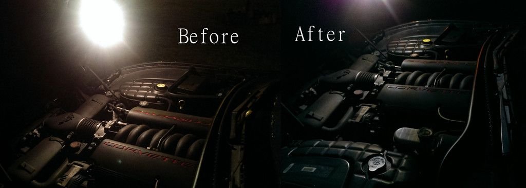

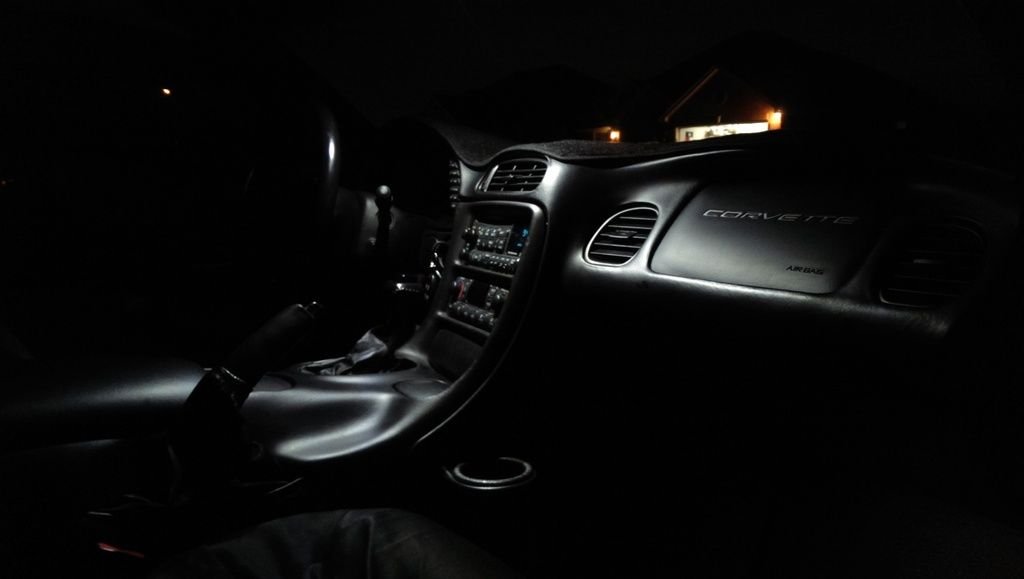

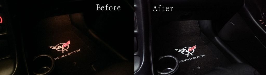

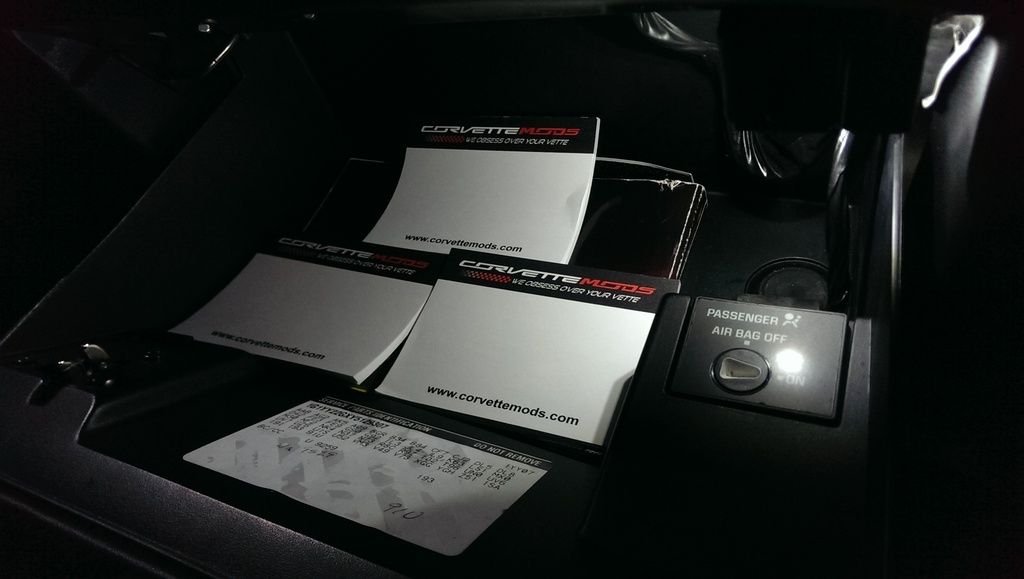

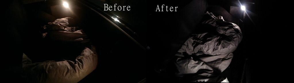

The fuse was definitely blown! I replaced it and it did actually increase the brightness of the LED's when the key is on or the engine is started. If the car's not on, for whatever reason, the glovebox LED and underhood LED are really, really dim. Not a huge deal, but if any one knows of a fix for that, feel free to share!
Took a few before and after pics with my cell phone, here they are;
