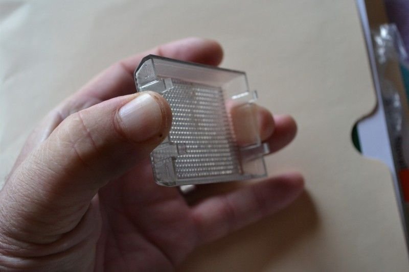

This is what the clips that hold the hood light cover is place look like
Grasp the light cover like in the pic below and squeeze the two ends...
while gently pulling out...one end or the other should release and then the opposite end will slip out as well...

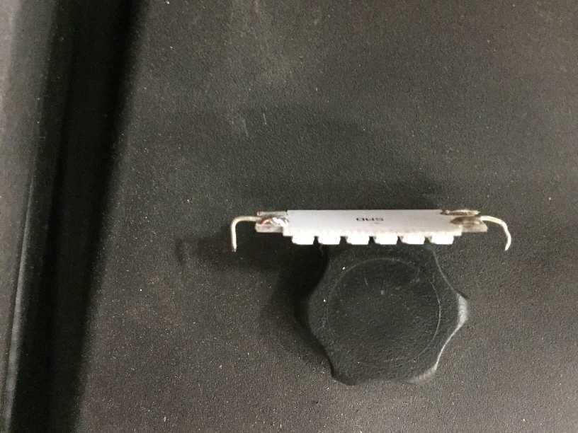

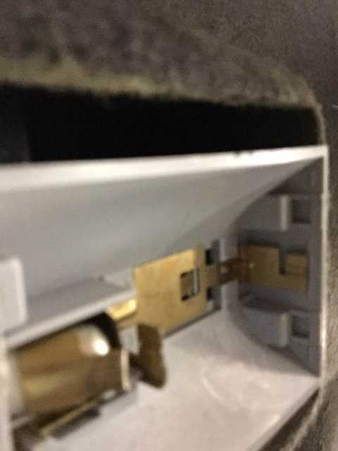

Forgot I had the car with me (DOH!) and just took a few pics for you. I was wrong, I modified the bulb AND holder...
The wire loops on the bulb were too short, so I unsoldered and replaced those with long L shaped legs from music wire (the existing loops were too short to cut and rebend):
I then modified the ends of the bulb holder clips by cutting two slots in them with a small Dremel fiber cutting wheel:
Bingo...problem solved.
Make sure you get the lengths of the wire legs right, too short and they won't fit, too long and the bulb will not be retained with enough tension (though you could bend the tabs a bit, but I was worried about breaking the plastic mountings).
Barry
