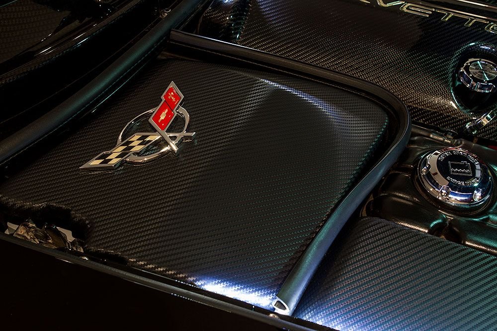

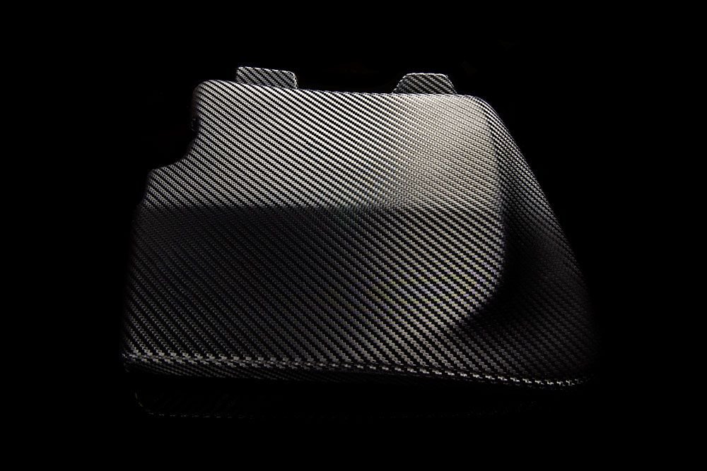

I have used it successfully on several other parts. A couple of the exterior parts have been on for about 3 years with no wear yet.
