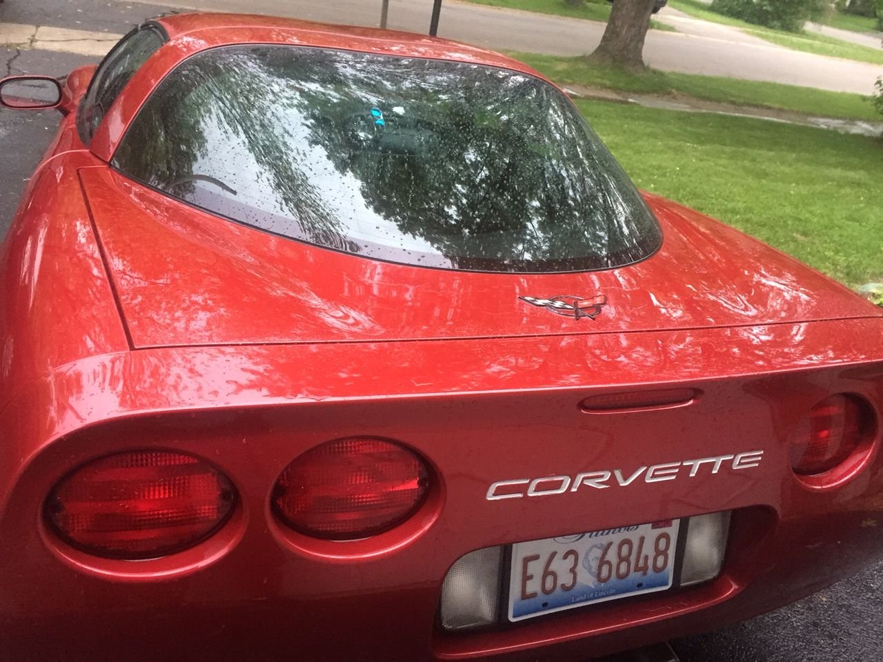

I'll post pics as I get the upgrades in place. Until then, here are some baseline pics. I'll also add one of them as my sig.
