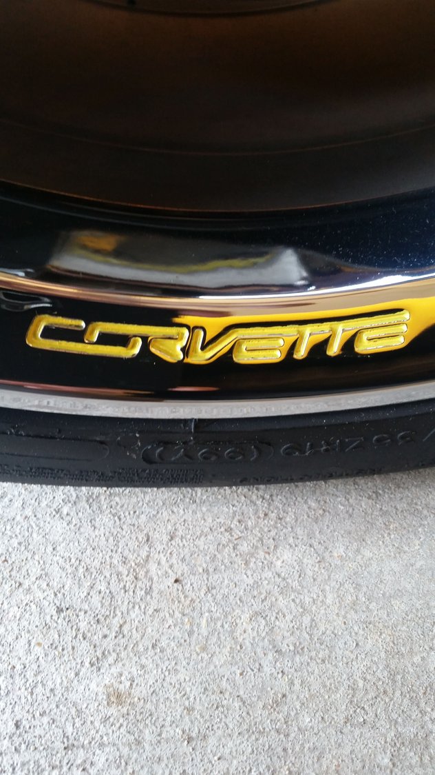

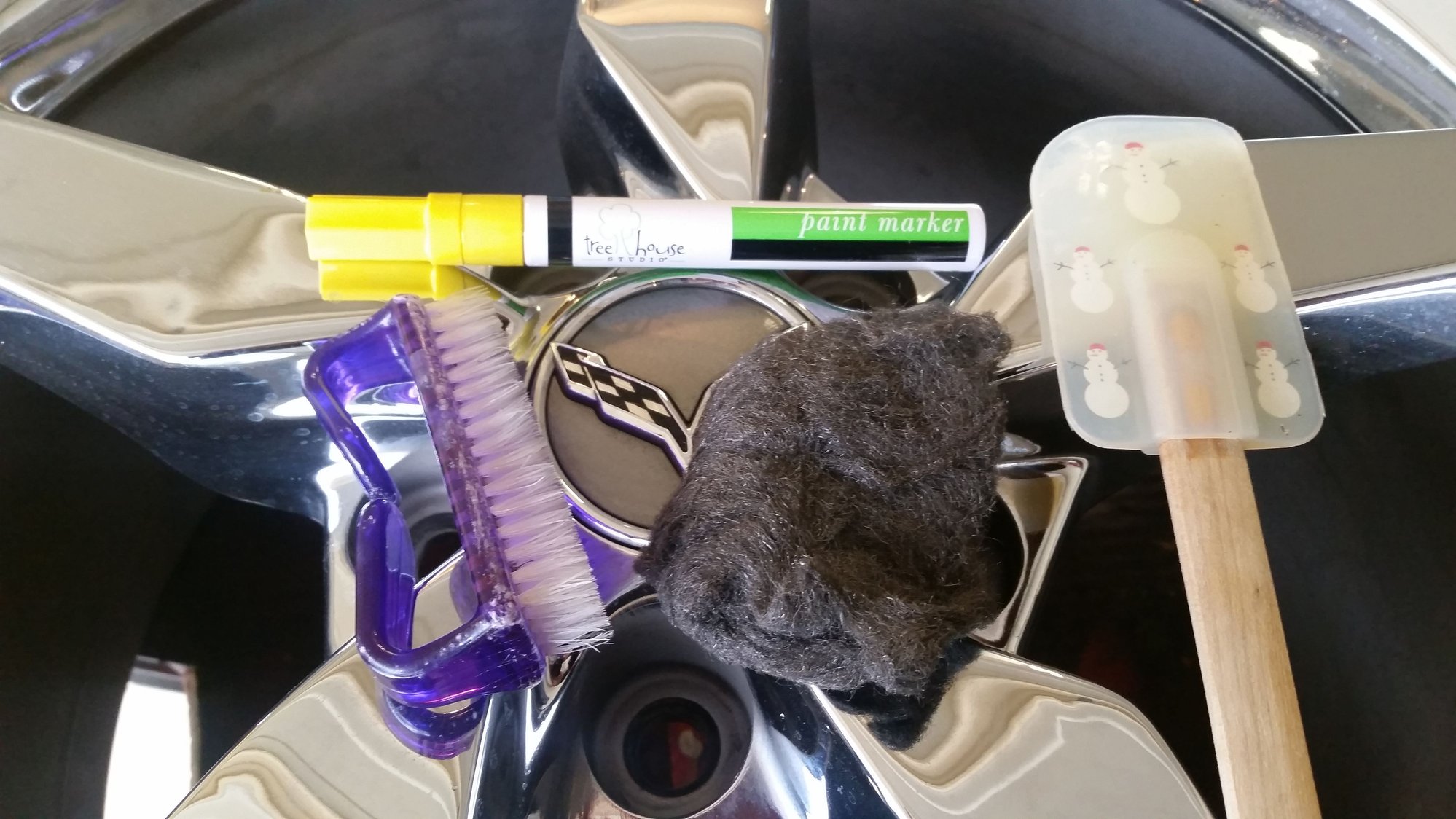

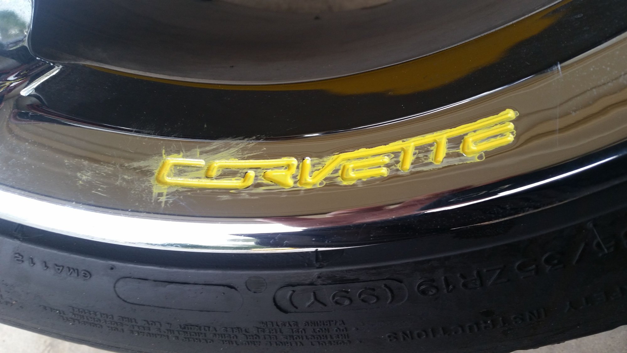

This only applies to chrome finish. Steel wool double, 00 is the finish or texture of the steel wool. Most of you may know this but steel wool does not scratch chrome it will clean anything off of it from road tar, to bugs that have been there for weeks, I used to clean my rims or any chrome grill with a solution of some type which required waiting and wiping it off, however steel wool mechanically removes unwanted material and buffs it to a mirror finish. The following pictures will be of the tools that I used the first pass of paint basically you can slather it on don't worry about overlapping it getting on to places that you don't want. let it dry, take the steel wool and run it across the letters . it will remove everything outside the imprint as you can see in the photos. I thought I would need the squeegee spatula, however when I tried to do this it smeared. Also there is a photo where I didn't wait long enough for the paint to dry when I started to use the steel wool and you can see where it drug the paint out and even at that point with the paint all over the chrome, I waited until it dried and then polished it off. now if you zoom in you can tell that it's not totally solid but you cannot tell this by standing and looking at it plus I was in a hurry wanted to get it done I waited too late I plan on redoing it today, not actually doing it just applying more coats of paint. Also the paint pen that I used I bought from Hobby Lobby for $2.95. However I had to trim the tip thin enough to fit in the imprint which is very easy because the tip is made of very soft wood fibrous material. I just took my knife and on either side went straight down and then broke it off where it started the handle of the pin. Sorry for the long post hopefully my pictures will come across if not I will attempt tomorrow. Also another very important point when dealing with this particular type of paint it was fairly runny and then so you need to take your tires off and lean them such that the imprint is level and the paint does not run out and drain across and on the tire.
