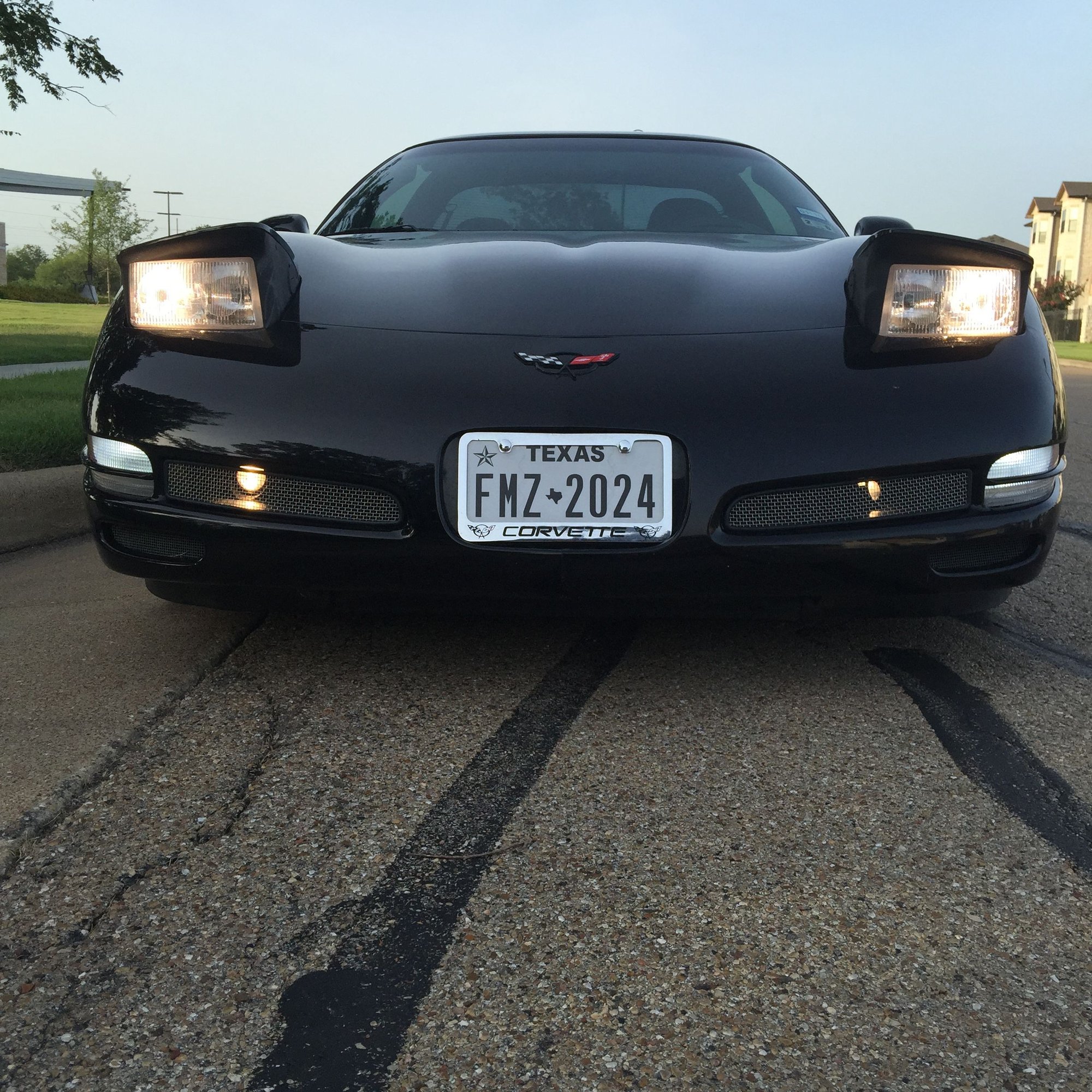

I know that one foglight is messed up. it came that way. I know the DRL doesnt have much function, but Id like them all to look like they are the same color white.
Your DRLs look to be in the 6000K range.
