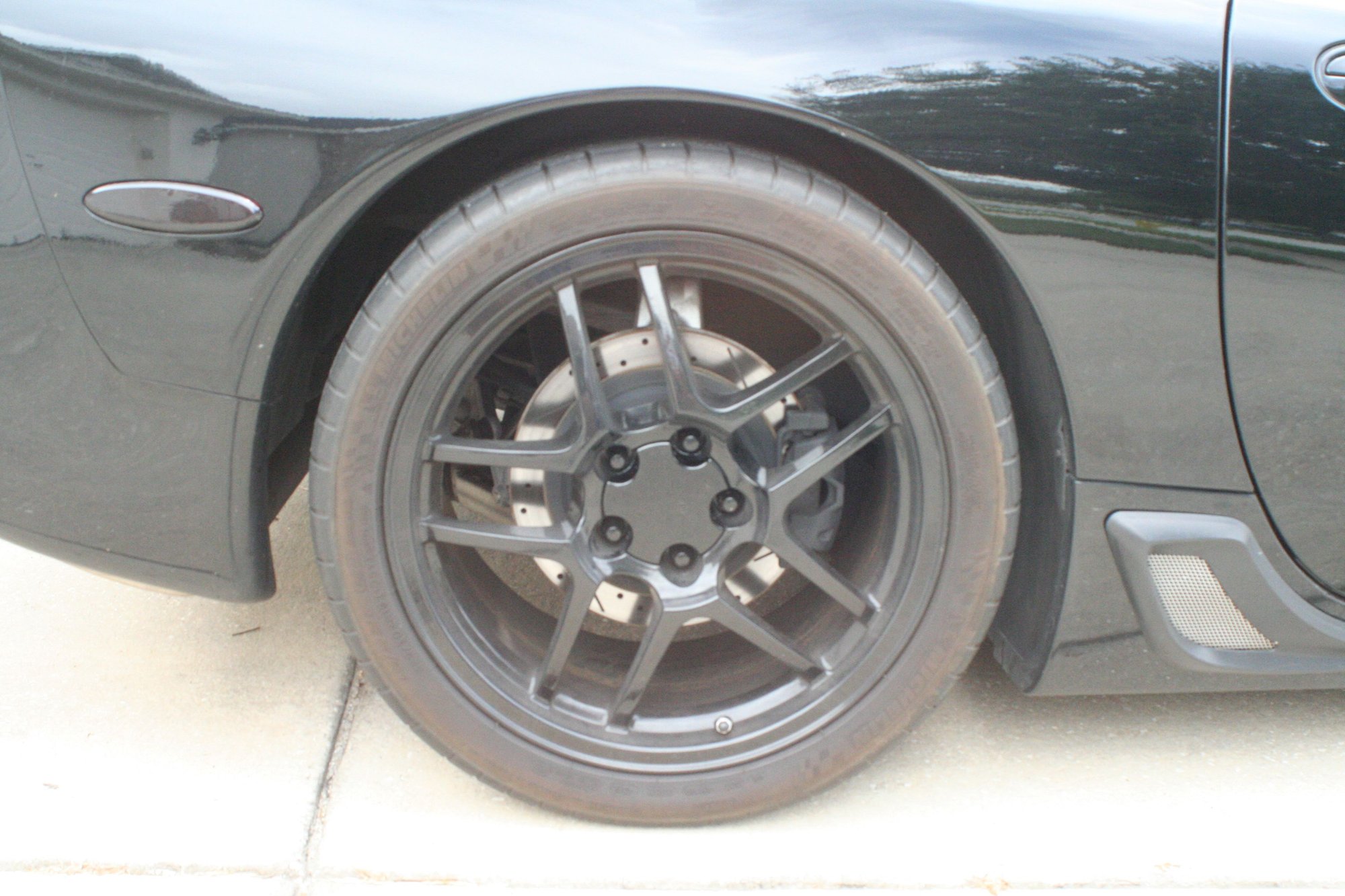

My 99 FRC wobbles. Not in first gear, but in 2nd. The body of the car wiggles from 40-70mph. The rear tires are 325mm wide. Is it the rears tramlining? Alignment? Suspension? Is it a shake, shimmy? I am not sure.
Thoughts?

Michelin Pilot Super Sport 325/30R19 on C5z rims.
They have 6mm of thread and look fine. 3 years old.
30 psi cold 32 psi hot.
I will check the links.
On c5z or c6z....no way it fits on a c5z wheels. If its c6z, are they repros or OEM?

325 runflat on a 10.5 wheel could be your problem. That stiff of a side wall that stretched could mean its not seated properly. I would start by getting the tires road force balanced.
