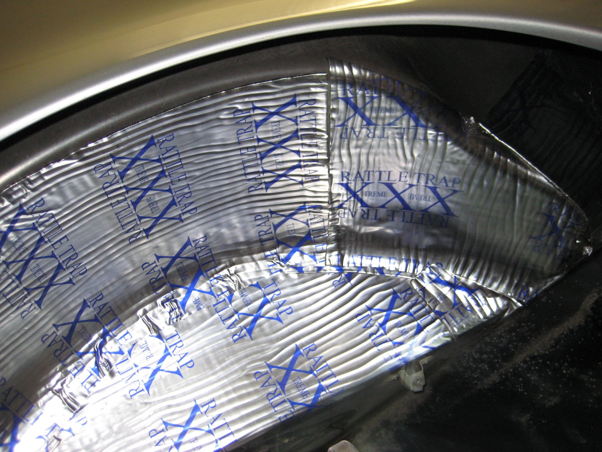

Well I was insulating the rear inner fender wells... and ran out of material...got the drivers side finished... SO I drove the car to town 25 miles away on TERRIBLE roads and was shocked at how much quieter the drivers side was than the passenger side...WOW
The usual thump, thump, thump, where they have cracks and have poured tar in the cracks was WAY quieter on the drivers side... barely audible...while the UN-insulated side sounded even LOUDER now I guess because the other side was SO much quieter... The usual whine on concrete pavement was pretty much gone on the drivers side... but, she was whistling away on the passenger side...
Back home and now doing the passenger side... I already know HOW much difference it's going to make so it's making enduring the heat and doing the job MUCH easier....
If you've been putting this MOD off or just doing the INSIDE of the car... DON'T put it off anymore... I have completely covered the inside of some cars with Dynamat and it does help a LOT... but, nothing I've ever done to a Corvette has helped as much as SOUND DEADENING the rear inner fender wells...

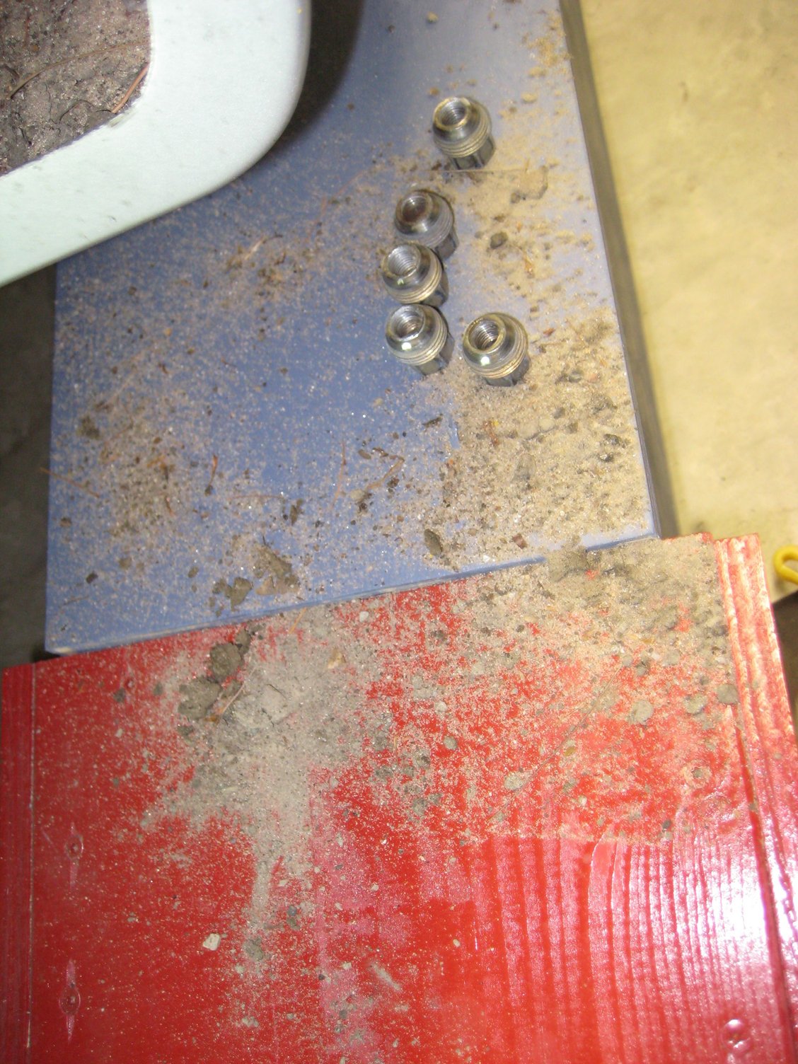

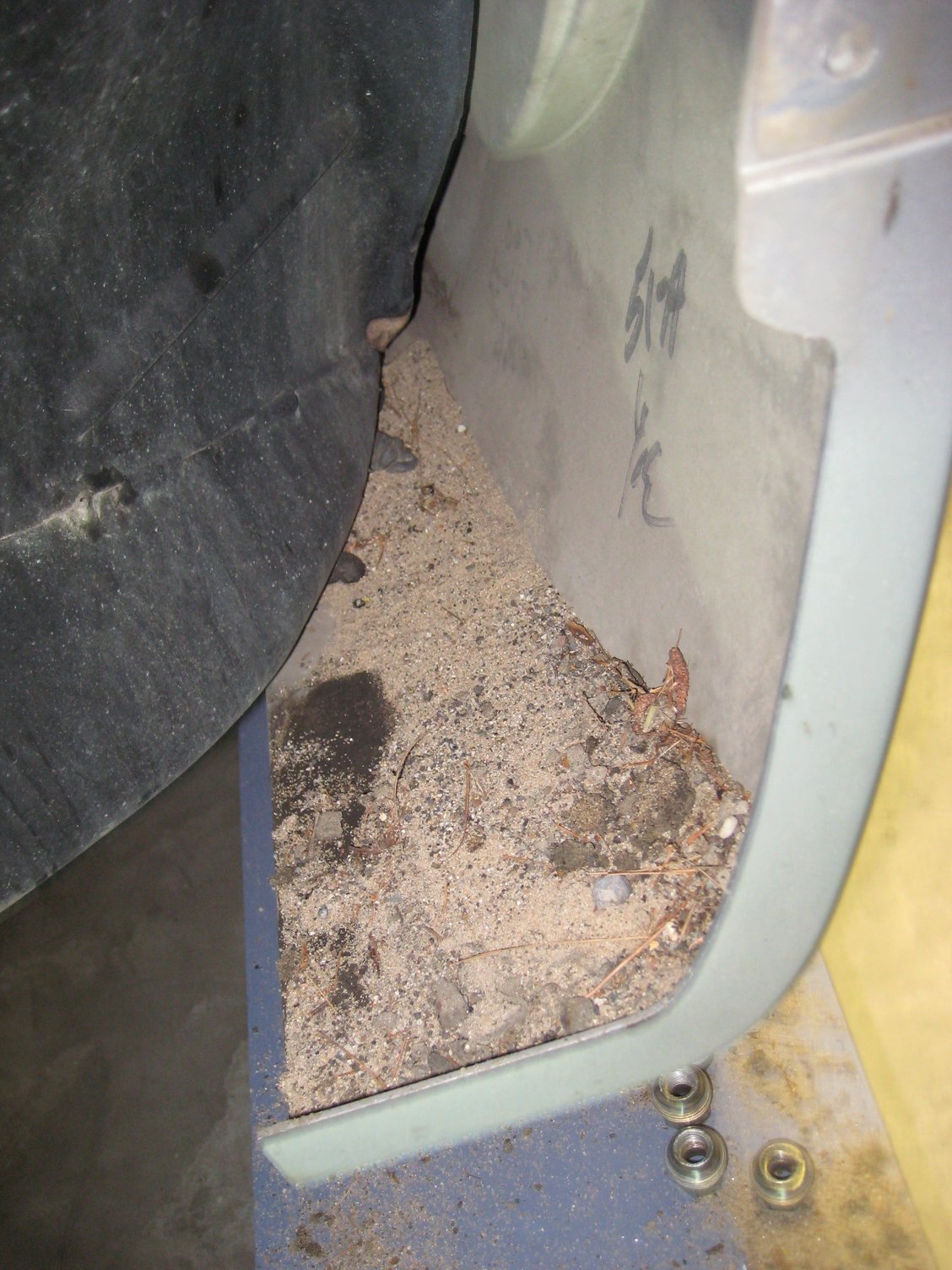

Did you find this on your car ????
and I used Fat Mat on mine big difference !!!!!!
Old Jul 19, 2015 | 08:03 PM
73Corvette's Avatar
73Corvette
Joined: Feb 2012
Posts: 6,644
Likes: 479
From: OK
LOL Yes I did... shop vac took care of it... nice job
