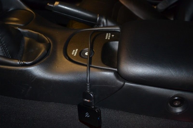

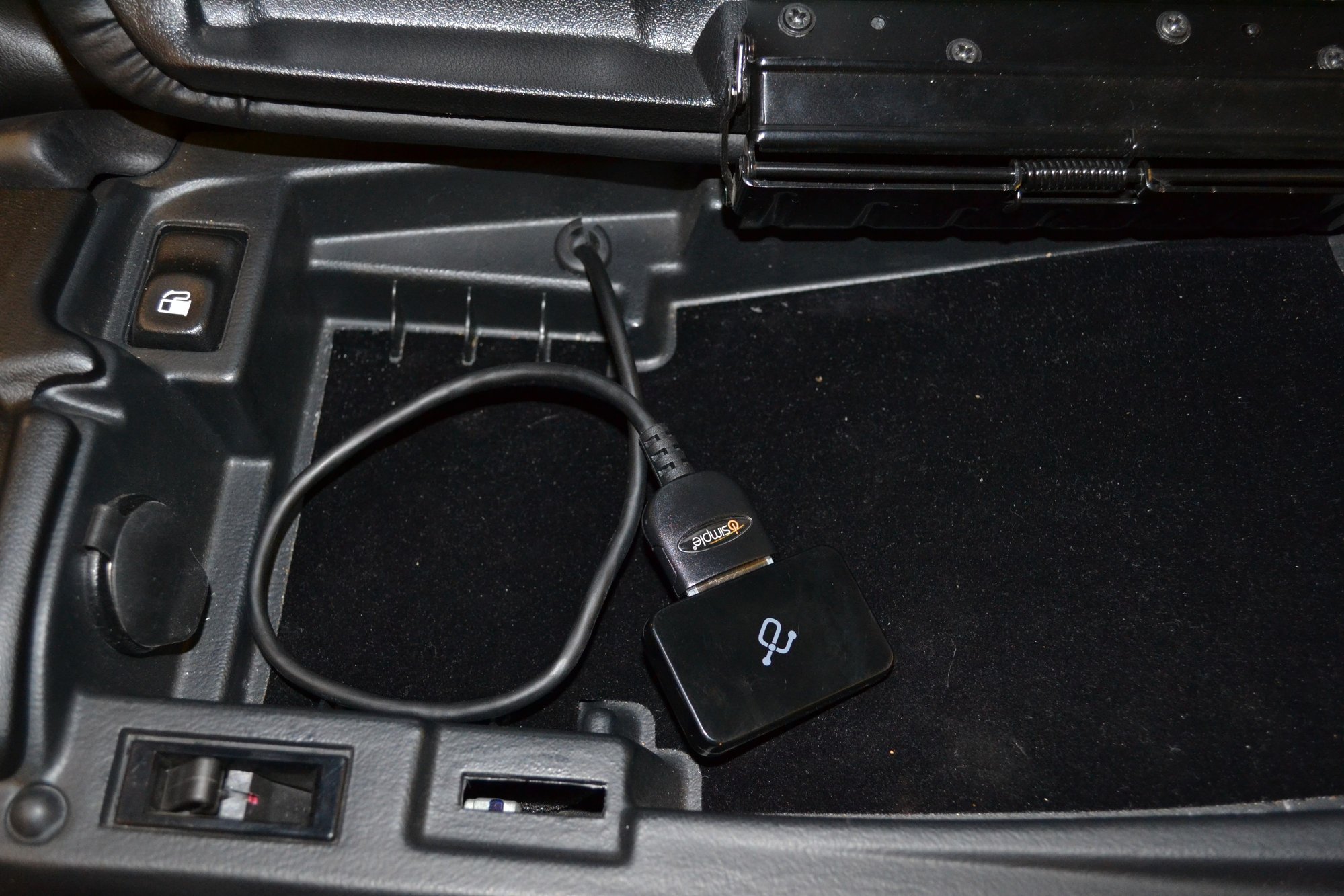

I upgraded my speakers in our 04 vert to Kicker replacements...
and also used adapters to hook up a 30 pin Ipod cable and then bought a 30 pin receiver for Bluetooth.... so now I have the options for Bluetooth from my Android, Ipod, CD, or radio... and the interior still looks bone stock... If I didn't live in near the KICKER headquarters and feel I should support them I would have probably upgraded to Polk Audio speakers...
but, the quality is much better and after some serious sound deadning it has plenty of power and a nice clean sound...
